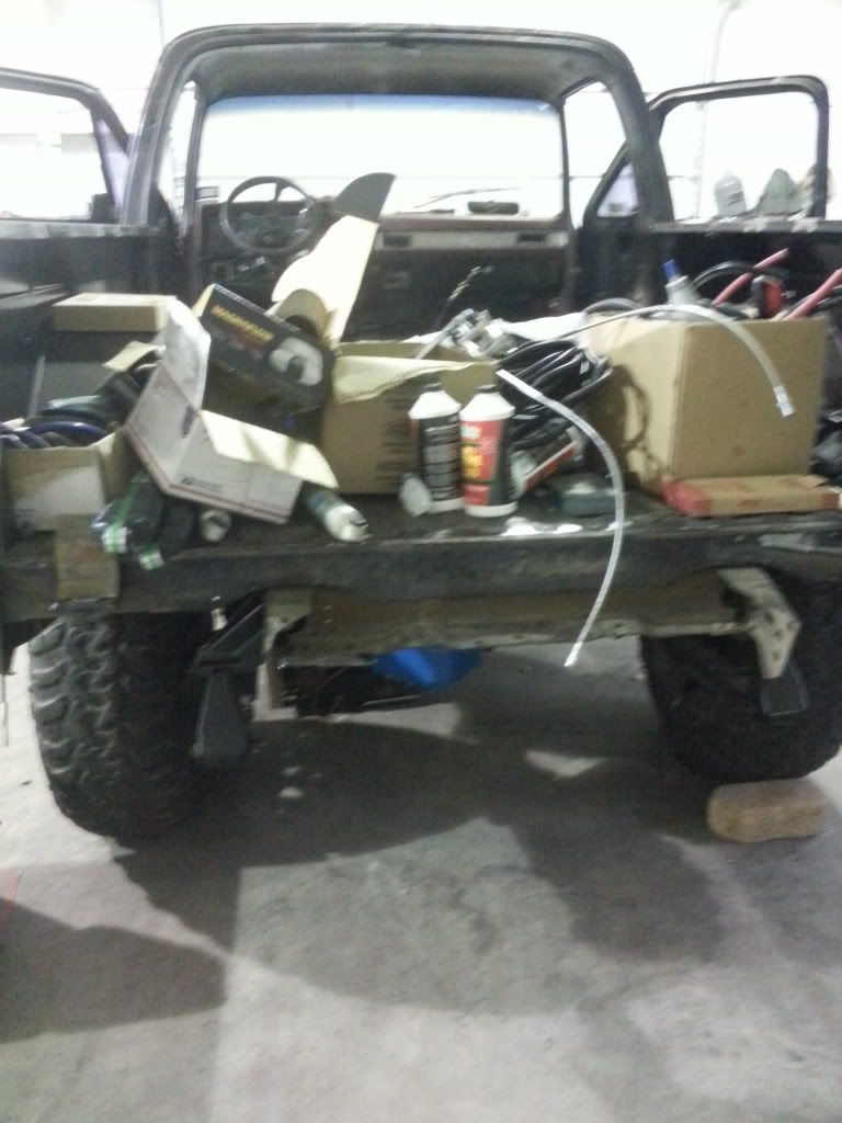

So lets see.... time to update. Trying to figure out what my last update was.
Been wrapping up odds and ends on this thing when I can. I finished up my wiring harness for the taillights and fuel pump. The original harness was broken and had exposed wires all over the place, as well as the previous owners hack job wiring for who knows what. The original harness also had all the wiring for the window in the tailgate. I have stripped the window/motor/etc out of the tailgate to lose some weight. Oddly enough the power window motor, regulator, and window were all pristine condition, which cannot be said about the window in my white K5. It barely rolls up, and the window is scratched badly, so all of this stuff will get repurposed to fix my white K5s power rear window.
I ripped it all out all the way to the bulkhead connector at the firewall and started fresh (ish). I cut the wires about 8" from the connector and soldered and heat shrunk my new harness on. To make things easy, I used a 4 wire trailer wiring roll so I didn't have multiple individual wires. One night I was browsing random crap on amazon and bought a weatherpack kit (Weatherpack Delphi Terminal Connector Starter Kit with Crimper & Storage 162pcs : Amazon.com : Automotive) and a bunch of wire loom so I can do wiring correctly from here forward.. This is awesome to have as you can fix alot of the plugs on GM vehicles, plus the connections are far superior to butt connectors. So long story short, I have built a new harness that is soldered, heat shrunk and has proper connections to last another 20 years.
Then it was on to some door panels. I unfortunately don't have any pics of them finished, but here is the idea:
I am covering them in a little bit of foam and orange and blue vinyl to stick with my orange/blue theme. I'm not entirely sold on the vinyl cover as it doesn't seem to want to stay glued down, and the fact that I really think I like the sheet metal look better.

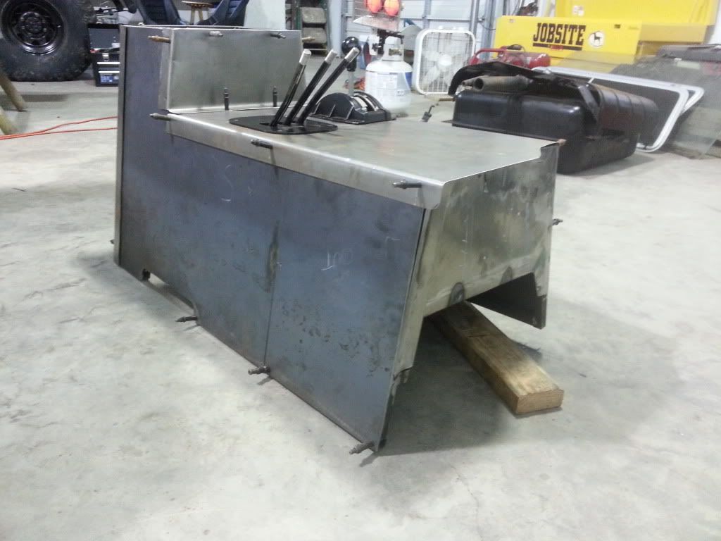

Then it was on to finishing my damn console that has been taking for ever to build. It has been extremely tedious since all I have to cut and shape sheetmetal is an cutoff wheels and flap wheels. I really want to get a nice brake and sheer in the future for more of this kind of work. I did build a small brake onto my welding table for about $30 in materials a year ago. It isn't perfect, but it works good enough for this job. Anyways, on to the pictures:
I grafted some 20 gauge on to the front of the console to help keep the heat in the blazer in the winter (otherwise it would just be a big open hole. I also am using this as a mounting point for the front. I bent a flap under and gusseted it so I can bolt it in without having to add any more weight or add some other way of mounting it:
And the console buttoned up with clecos. I still have to cut a slot for my cutting brake, paint all the panels and frame, and make a top that is hinged and padded (for an armrest), but all the hard work is done. once that is compete, it will be ready to bolt in for good.
So that gets us about to where I am now. Its just odds and ends to the finish line now. I need to get the fuel tank back in and run my fuel lines, fab up shock mounts, move my front axle forward and put my new shackle hanger in (DIY4x) to fix the shackle angle and bring it down a bit, modify driveshafts, get the exhaust done, and do some misc wiring and it will be ready to wheel.
Pile of parts left:
