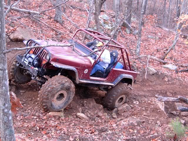

Here are some pictures of Ritchies Jeep that got tore apart for parts for this build.

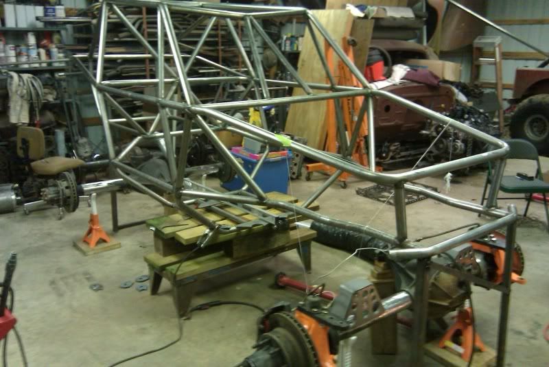

Of course we went to Randy Rodd, owner of Jimmy's Outback 4x4 for a chassis. Without his help I don't think we could pull this off, and I am still not convinced that we can. This car is to debut at KOH on Feb. 9th. The thing that may save us is that Jimmy's has tons of bracketry for us to simply weld into this car, if we had to fab all of this stuff there is no way we could do this.
Here is the chassis as of last Saturday
Having the axles already built (except for steering) is going to really help.

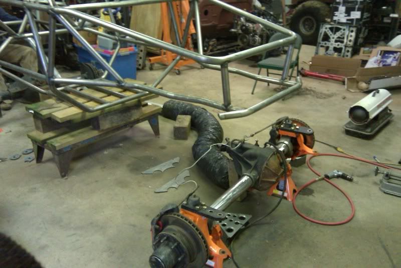

We got the chassis and axles at ride static ride level and started putting brackets on for links.
After realizing that the tires were going to hit the links at about 35 degrees, the towers were moved in a couple more inches to allow steering in the 45-50degree range. So far I think all of the link brackets have been moved at least once and now the motor mounts as well. And after last night we are just slightly further than the last pictures. So after doing everything twice so far and having already registering with the number 202 for the LCQ and being the 2nd Crush Motorsports buggy, came the name "Deuce". Hopefully this build ends up only taking on the numerical meaning! Once we get the stuff out of the way that we have never done before (mainly suspension setup) out of the way I think we will be cruising right along. Links have been measured and Branik will have them to us shortly!

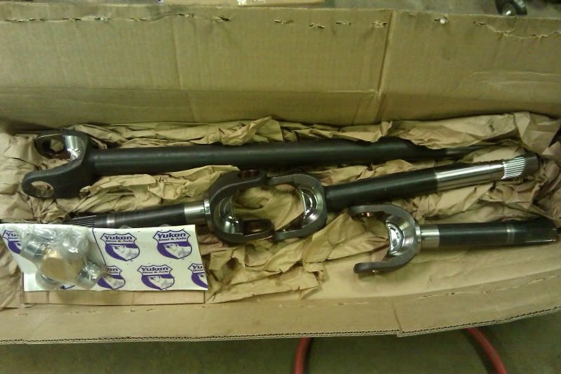

50 degrees axles from Branik

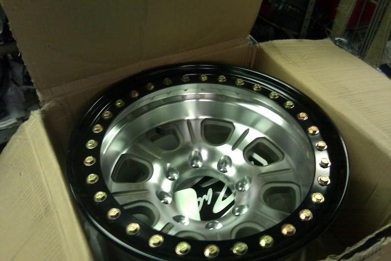

Raceline wheels for some bling

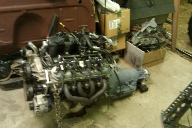

5.3L with Turbo 400

A few more parts from Branik. Thanks for the super quick turn-around time Stan! Hopefully we can make some good progress this weekend.

Here is where the front tower ended up, we are going to heat the cast and use use some nickel rod to try and make it stick for good.
We requested from Randy that the chassis be able to handle sharp steering with big tires and a narrow axle and he delivered. The only problem was that our old headers werent that tight, rather than go through the hassle of finding something that might work we just modded the ones we had. Nothing fancy but it works.
Passenger side
Driver side
pre-fabbed link towers, weld em and go
We decided to add some engine support in the rear. With racing it seems that the engine mounts and tranny mounts wont stay tight unless it is very well supported. We also made a cradle to go under the pan on the front two mounts.
Side view

Here is a shot of the engine mounting with a coat of paint. Due to time constraints we are not going to tear down for paint, we are going to paint as we go.
