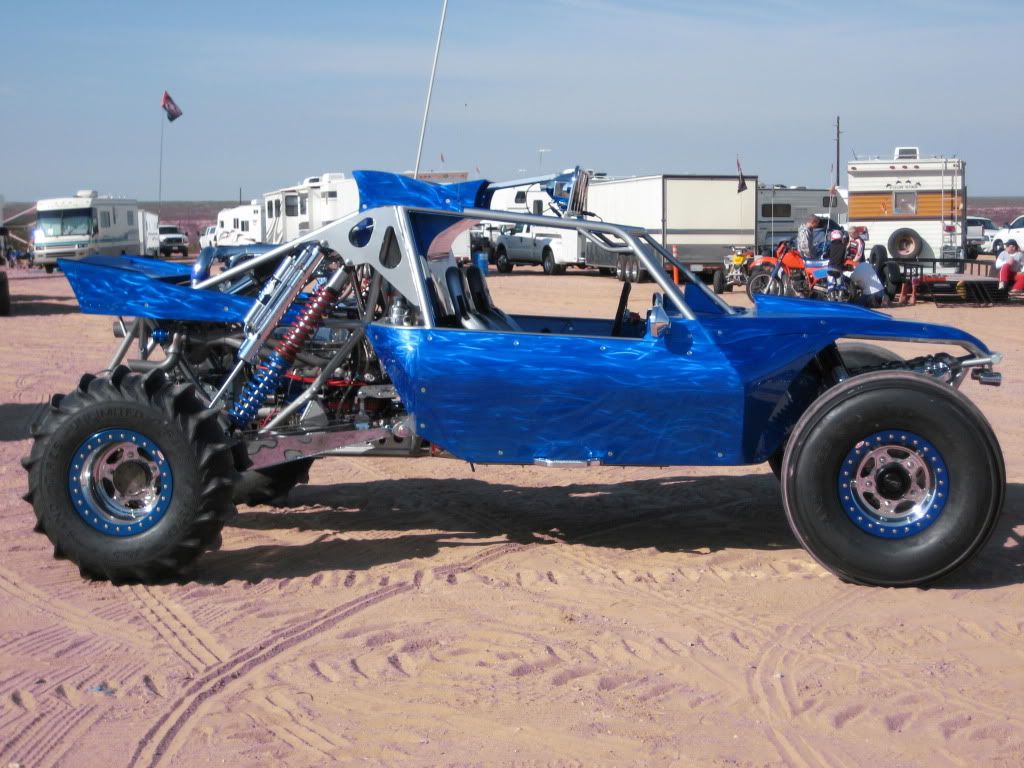

putting in a 60 front, 14 bolt rear, 4 speed atlas/th350 combo, 383 stroker..all midengine. i will be widening the body 6" to allow seating in the rear on either side of motor, 4 link front and rear at stock ride height and 40" tires..i already have bobbed 9" out of the rear and boatsided it halfway up the doors...plan on keeping it street legal..all a/c, heater, etc..by widening the body it should also match the axle width, not needing mud flaps hopefully..fuel cell will be under hood, winch will be behind grill...full "sleeper" i hope..:)..i am going to re-uploster cage into body and everything to make it all super fancy on inside, rear cantilever "hemet/mezzanine" arm in rear..will be badass!..will post pics as i go along...its in my shop now..
