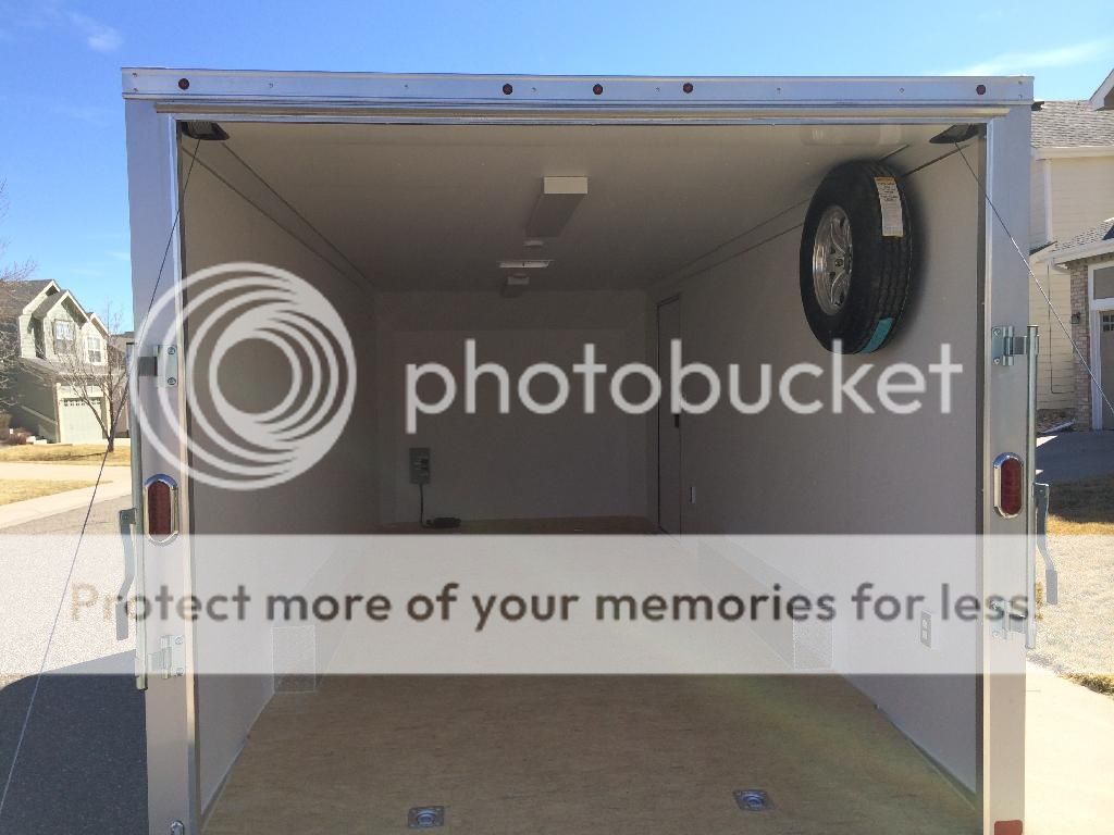

I've had a 24' enclosed for 3 years that I haul my buggy, ATVs, and a few other things in. After learning from that experience, I'm having a new one built.
New one will be:
aluminum (instead of steel)
28' (instead of 24')
6K, 8 lug axles with 16" wheels and 10 ply radial tires (instead of 5.2K, 15" and ST bias tires)
Spread axle
6" shorter height (total 7' inside) since I don't have a 7' tall truck anymore
rounded top front edge to help with wind and mileage (maybe)
extruded aluminum floor (instead of plywood so oil can't soak into it)
white aluminum walls (instead of plywood so tire rub marks will come off and it looks way nicer)
cupboards and drawers in the front (instead of plywood shelves)
(possibly) a tire well in the floor for my 40 x 13.50 spare
(possibly) a fuel tank and pump in the floor so I don't need to keep 6 cans in back of my truck
LED interior lights
toolbox on the tongue with a deep cycle battery inside
white exterior so it's not like a hot box inside (instead of black)
reinforced wheel wells so I can drive on them if necessary
Anybody have any advice on anything else I should consider adding or changing?
New one will be similar to this:

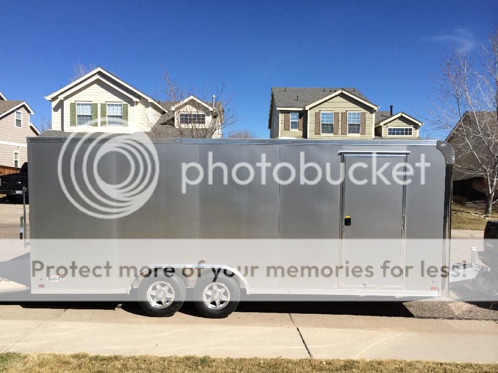

I just picked up my ATC raven a week ago. I stayed with a quality manufacturer and I see you did your homework also. The only reason I didn't go with the quest was because of the extra weight. This unit weighs in at 2900lbs. Also do the screw less exterior and extra height. It makes resale easier if you were ever to sell it again. Do the front bevel though definitely. I'm going to epoxy my floor though as the coin flooring was just way too expensive . You can really go wild with these trailers.

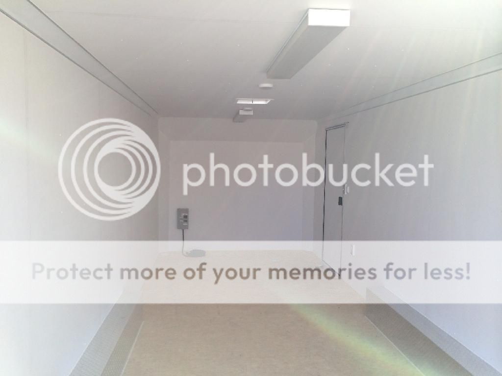

Getting closer to finalizing. For the sake of discussion, here's some thoughts....
For me, this isn't the “be all end all of trailers.” This one is going to be $25K by the time everything is done (including tax), and we were hoping to keep it under $20K, so I do need to be particular on what we "need" versus what we "want" or "would be nice to have." It’s too easy to turn this into a $40K trailer that needs a dually to tow.
I talked to my sales guy about this and he said a lot of guys come in wanting 8K axles and 19.5" tires under their 24' trailer. He said that's the best way to wreck your trailer, especially with aluminum frames that can fatigue crack over time. It will shake everything to pieces because the suspension and tires will never move. He's had the most warranty claims on trailers with grossly oversized axles on small trailers. It's $1200 more to upgrade from 6K to 7K and I didn't even ask about the 17.5" tires. I'm going to stick with the 6K 8 lug axles, 16" wheels, and 10 ply tires and hope for the best. It’s already a huge upgrade from what we had before.
6K axles gives me 12,000#
(Estimating heavy)
*Trailer weight 4500#
*Buggy 4500#
*Two quads @ 400 each = 800#
That gives me 2200# for everything else, which I know we won't exceed with what we normally carry in there. There’s always the back of my truck to offload if necessary.
  • Gooseneck, I don't want one.
  • They want $2000 for a 24 gallon fuel tank in the floor... nope
  • They won't make a tire well large enough to fit a 40x13.50. Structural problem and I agree it hangs too low. I guess the spare stays on the floor.
  • They won't just reinforce the fenders. They will only do ramp-overs for $1600. Too much money and they waste too much floor space. I think this time I'll have some steel covers made with ramped ends, have them powdercoated, then mechanically fasten them in place.
  • Floor will have 8 flush-mount tie-downs appropriately placed for the buggy and quads. Flush-mounted e-track for 22 feet would be $800 more.
  • I need to ask about step options.
  • Don’t want fold-down chairs or beds. Camping chairs and an air mattress work fine for that. And there is no good place to put them with the current layout.
  • Interior lights will be abundant. We just need to see what they have to offer.
  • I’m going to ask them to wire it for exterior lights at the back door and side door. I’ll mount some LED floor lights inside facing outside through the door.
  • Cabinets are going to be expensive, like $3K+. Doing a factory tour on Wednesday and we’ll decide for sure what to get.
  • Two roof vents
  • Extra large bumpers on the ramp door (my last trailer skin got punctured by a rock at Moab – oops.
  • I have a Yamaha 2000 generator, but we’ve never had to use it. I’m not going to do a wired generator door ($1000) or AC power package ($700 for basic or $1400 for deluxe).
  • AC/heat is something we wouldn’t use much. If it’s that cold, we’ll probably be in a motel. A propane tank with a radiant heater would be all we need. AC I might regret not getting, but that’s $1800 (for a 13,500 BTU unit) we’ll save.
  • I'm on the fence about the rear rollers (bogey wheels they call them). They do put a skidplate back there if you don't have them. If you add rollers, you lose about 3" of ground clearance, which I think will hit all the time. $252 for those.
Here's the quick layout I did:

I love my ATC.
Mines a 24' with the full electrical package and factory cabinets etc...
Ive had several trailers and I always went cheap and then added my own cabinets, wiring, A/C etc... myself later.
All of my past trailers also looked pretty hack compared to this one. I always used good stuff and the install was good but its not the same.
I finally caved in and bought this one ready to go. No mods needed and I am so happy I did.
I know it sounds cheesy but every time we take it out I get at least 1 guy checking it out and complimenting on the construction and overall look and function.
My advice is just nut up and get every option you think you want right now.
The good feeling you will get about saving the $$ will wear off quickly especially when you see another trailer with all the stuff you wanted on yours.
