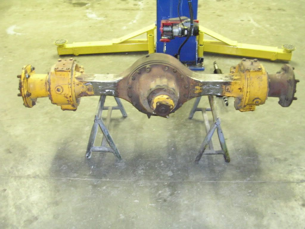

This project first came to light when I came across a decent deal on a pair of 2.5 ton rockwell steer axles, (front loaders), I found them here in the for sale section & they were only a couple hours away to pick them up, A day & 800 bones later & I had them home, & here they sat for a few months one out in the yard & one in the shop getting the stare down,
After removing the stock mounting bracketry this it what they looked like,
After bracket removal I decided that the front diff would need rotated for better pinion\caster angle,

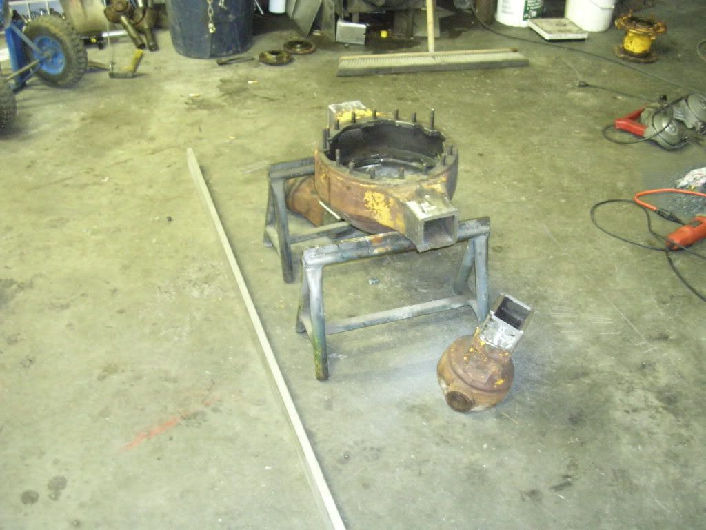

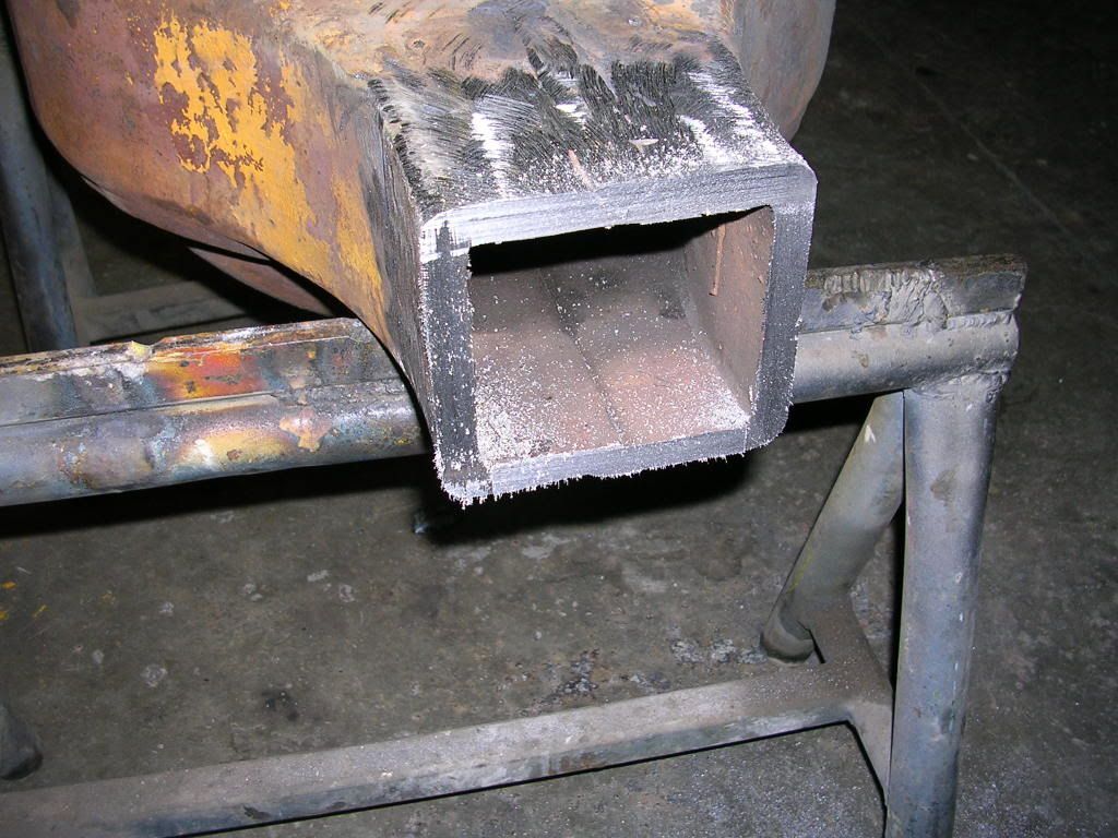

After disassembly the ends of the tubes were cut off,

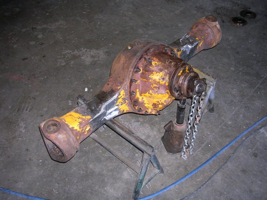

And after some carefull measuring & alignment I welded them back togeather,
So now with the knuckles sitting at 0* caster the pinion is pointed up at 20*

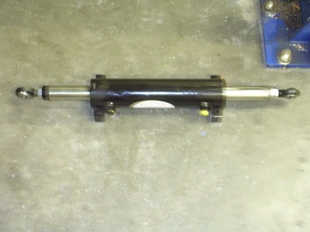

Next was the steering, I ordered a pair of these, one for the front & one for the rear,
#2 ·
I did not get many pics of building the cylinder mounts, but I did get a couple of building the tie rods,
& here is the cylinder mounted & the tie rods in place, also in this pic you can see the high steer arms that I built, when complete the will be a spacer between the high steer arm & the tie rod, so the rod end will be in double sheer,
