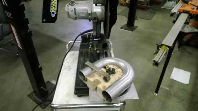

best tool for cutting u-bends into usable angles is the chop saw, followed by a 4.5'' grinder with the biggest cutoff wheel it will fit.
bandsaw is really only good for cutting long pieces as the vise usually needs the length.
we use angle finders to estimate where we're going, we have tube specific tools; but you can use 2 sticks bolted together. :D
cutting with the chop saw requires removing the vise, leaving the back of the vise
mark your tube squarely and hold it in the chop saw, no need to fixture or clamp the tube in an abrasive chop saw
the best chop saw fixture i've seen for cutting u-bends i found here on pirate4x4 (sorry can't give credit to the fabricator)

A little late to the party but I made this table after seeing a friend build headers on a similar saw. It's easy to line the bend up square to the notch on the backstop, all you need is to have your tube marked where you want to cut.
Fwiw, I made the table for about $10 using a free broken saw from work and scrap metal plus a remnant from the steel yard. Works great for lots of stuff.
