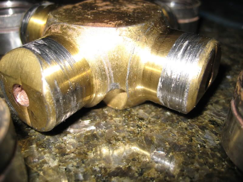

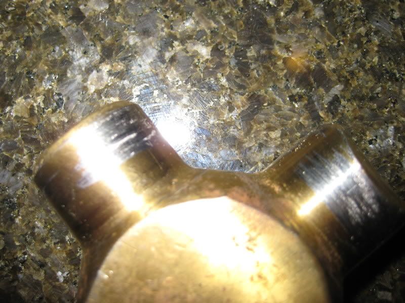

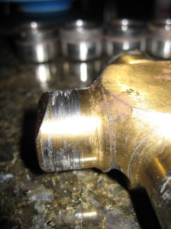

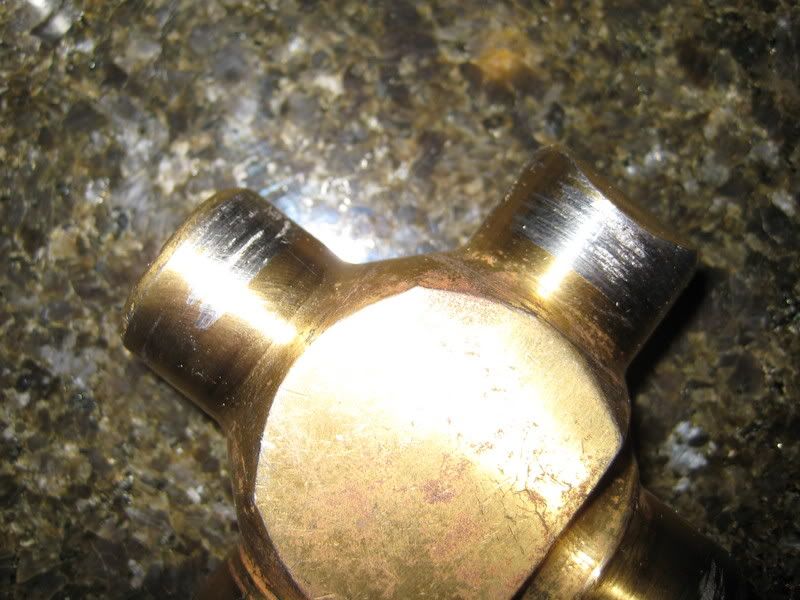

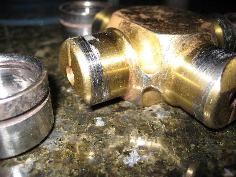

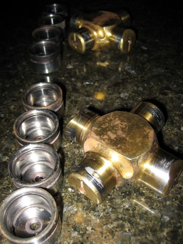

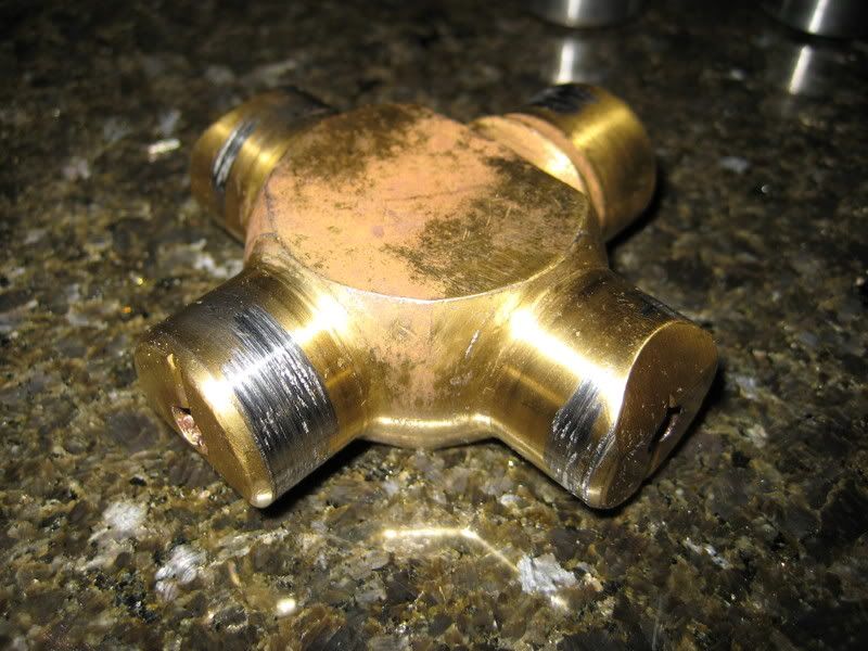

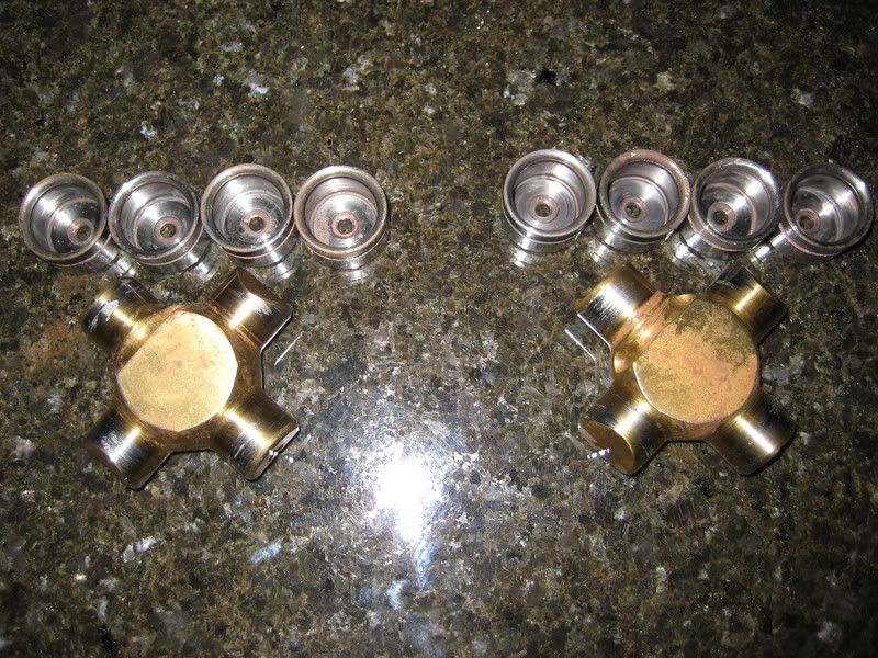

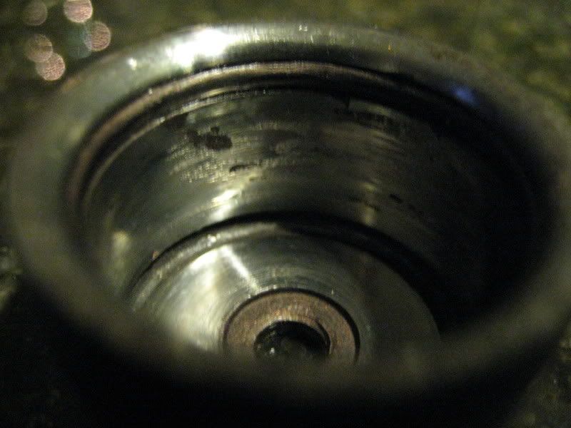

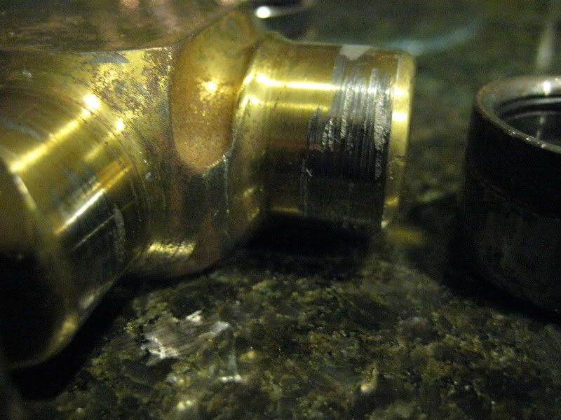

Hi all,
I was servicing the jeep last night, pulled the front axle shafts out to remove my Yukon Super Joints inorder to inspect them after EDIT "2000 km" of use. This is what I saw. I only used the special lubricant that was supplied with them when I bought them, installed them as per their instructions. I have an '05 Jeep Unlimited Rubicon with a Warn 5 on 5.5 conversion kit and superior inner axles and run 35" Super Swamper SSRs and 28374kms on the jeep. The jeep is a daily driver when I don't car pool to work and always I have the front hubs unlocked untl I hit the trail.
Can somone tell me what happened to them?

#11 ·
Definitely galled. It doesn't look like foreign debri.
I would first suspect lack of lube. Did you prelube them before assembly? It's extremely hard to get lube around all the surfaces if it's pumped in after assembly.
However, galling can also be the result of high surface pressure and rotation. The high surface pressure and rotation would generate heat and cause the lube to break down. This would lead to metal to metal contact in a very local region. Essentially you get micro welds that ends up pulling material out.
In either case you are looking at accellerated wear if you reinstall them. The edges of the galled areas will continue to erode generating debri. If this is a DD I would definitely replace them.

I think he nailed it....
There is something going on to gall it since the material on both the cap and the cross are pretty hard....
I would call randy's tech department--I am sure they have seen that before..

#22 ·
LACK OF LUBRICANT
I ran those same joints for 2 years, after 7 shattered Chromo shafts, I was still running the same joints and caps. I had a few that looked like that, I would run them, it is not going to hurt anything for a very very long time.
As far as how much to lube them, I can tell you were way under lubed, because it should have looked like a gold paint can blew up inside those caps. The antiseaze is the ONLY lubricant between the cap and the joint, no bearings or anything so yes they are going to get scarred a little even with a lot of lube. you need to coat the caps very heavy before you put that back together and then pump them with lube too.
Be carefull not to pump them after it starts getting pressure though, you could blow the O-ring out, then it would start getting dirt and water in.
Those are good joints, they will take A TON of abuse.
Run'em.... Lube'em.....Run'em.....Lube'em

#25 · (Edited)
As everyone has said that was caused by lack of lube, I see it all the time. They will not be covered under warranty for just galling. Lack of lube looks very similar to a rig that has seen a lot of street miles (with hubs locked, like in a D30) and that usually goes hand in hand.
I would say 80% of people that run super joints do no lube them enough. You can still run them, get some new o rings, and grease the shit out of them.

Hey, Thanks for all of the help. I am not nor will I bash these u-Joints, shit happens and I just needed your help to confirm my suspicion that it was a lack of lube.

#50 ·
That is the spec'd lubrication for them and they are designed to use it as opposed to a regular grease. The copper flakes are squished between the hardened metal surface under load and act as the bearing material. If the caps were a softer material it would not work. Many people use it without issue.
It doesn't work well in any sort of a DD environment because it has shitty resistance to being washed out by water, unless you grease them every time before you lock the hubs.
