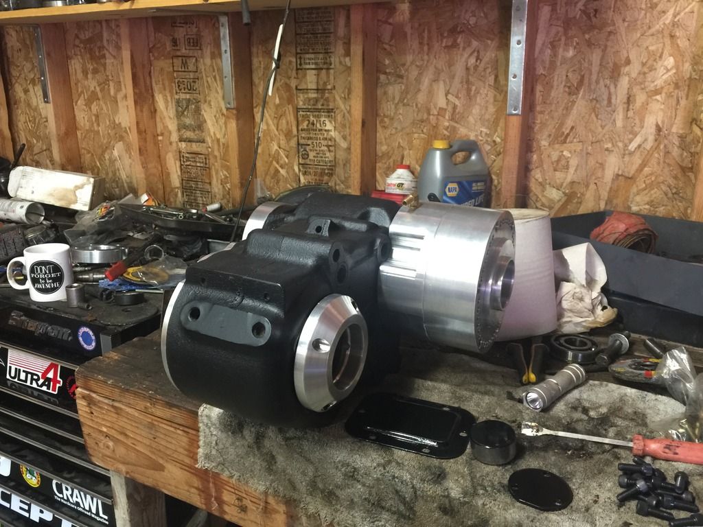

#24 ·
I have installed 3 ORD doublers in others rigs. Nice unit, well built. I ran a NWF 203/300 doubler in my rig for several years. I prefer their unit over the ORD any day. Had some issues with the clocking bolts working loose but it had to do with my mount/cross members and not their design. I have since put it in the kids rig and it is still going great.
That being said, for the new rig I went with the NWF Eco box to 205 and JB Fab shifter's. The Eco box is an amazing piece of work and I am very glad I went with it and would never got box to a 203 to whatever doubler.

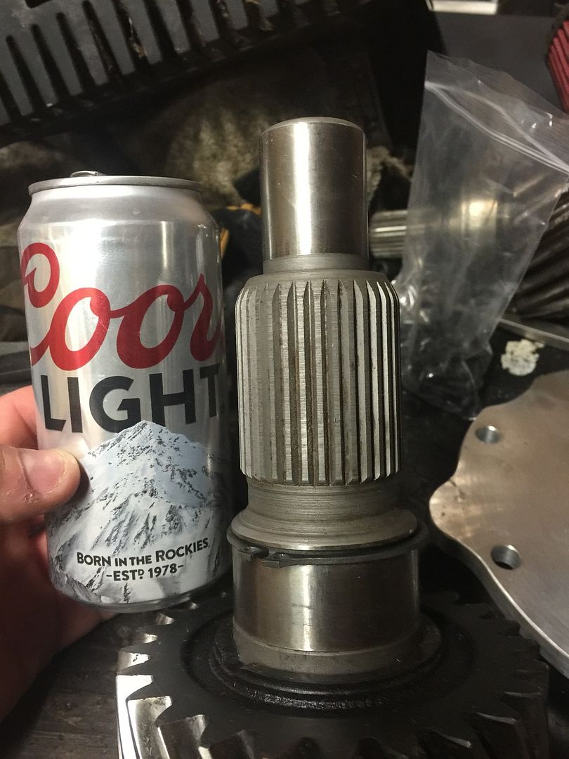

#25 ·
My problem right now is my budget. The ord magnum box interests me but its too expensive for me at the moment. The 203/205 can take a beating I'm sure we can all agree on that. I don't have a high horsepower engine so as long an I don't run the 203 in low 205 in high there shouldn't be much of an issue. My truck is pretty heavy though. The 203/205 is heavy aswell. A magnum box/ 205 is lighter and has that "fat shaft" which makes that connection stronger. I have the main components to make the 203/205 happen. A 32 spline 203 and a 32 long spline 205. I would need to covert it to short shaft for the 203/205. If I went magnum box it would come with a new input for the 205 so I wouldn't have to spend the extra on that input. I'm not as experienced as all of you so your input is appreciated. I'm thinking just save up a little more and do it right with a planetary. Does ord make a triple stick shifter for the magnum box/205? I couldn't find it on their website.
