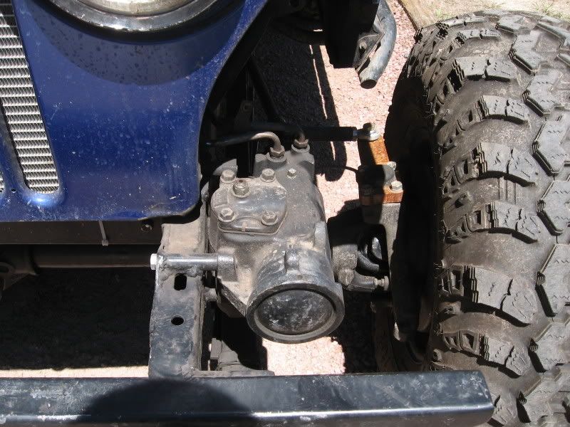

Originally I had just a power steering box, I had tweaked the pump and it worked pretty well, until it got warm. Then it completely sucked, and almost killed me a few times.
I decided to go with fulkl hydro, right now I am only on 37's, but plan to go to 40's or 42s soon, and I dont want to try and hang a box off this frame.
So I started the hydro mount, the diff cover will still come off.
