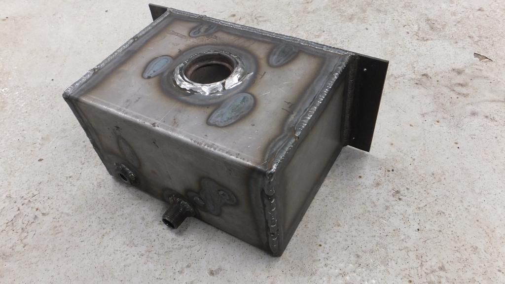

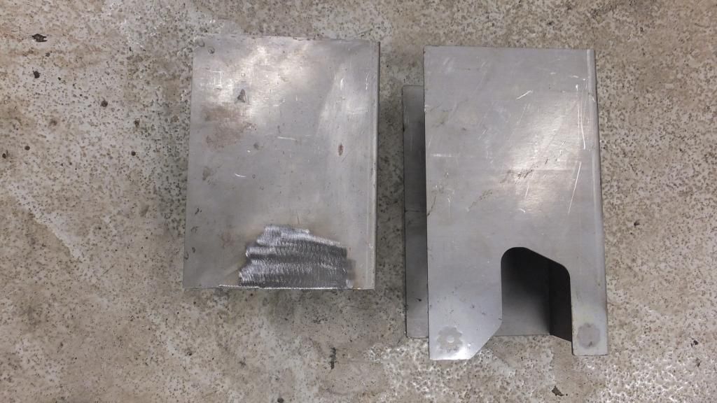

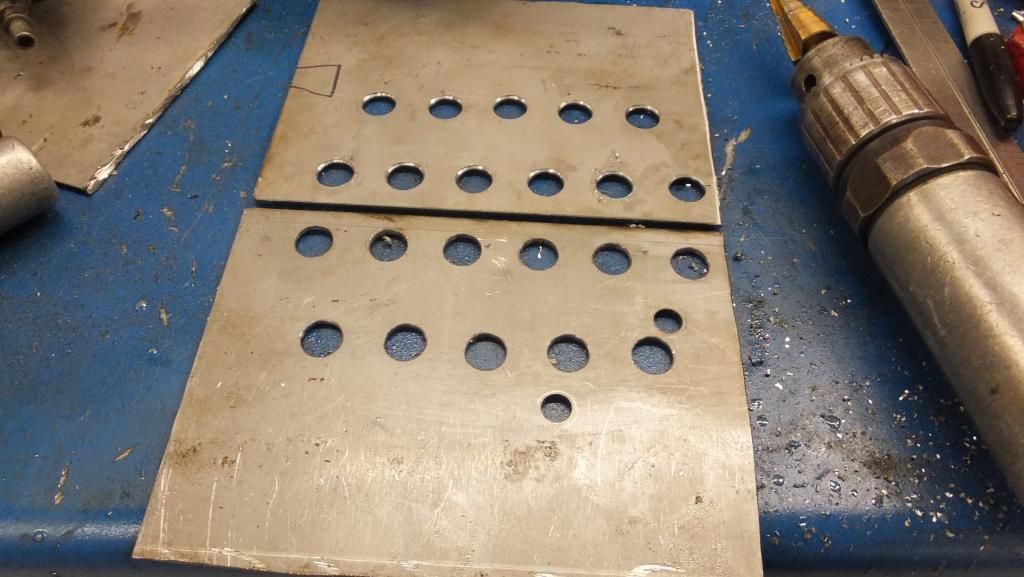

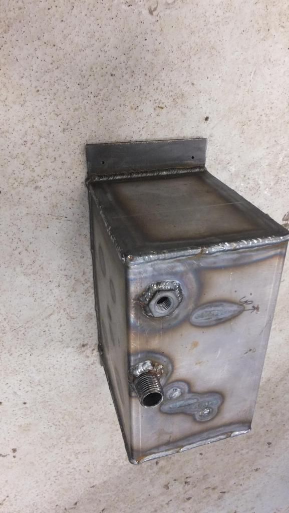

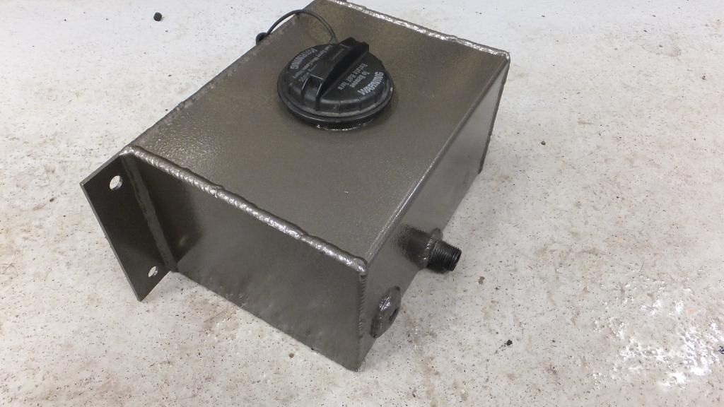

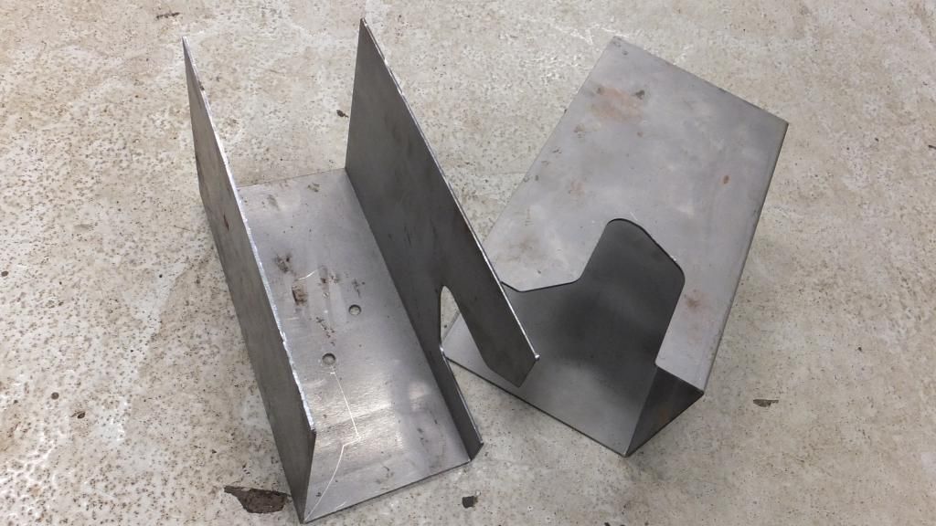

Some progress. I built a steering fluid reservoir mostly out of salvaged scrap. It will hold roughly 1½ gallons and mount where the ABS unit used to be.

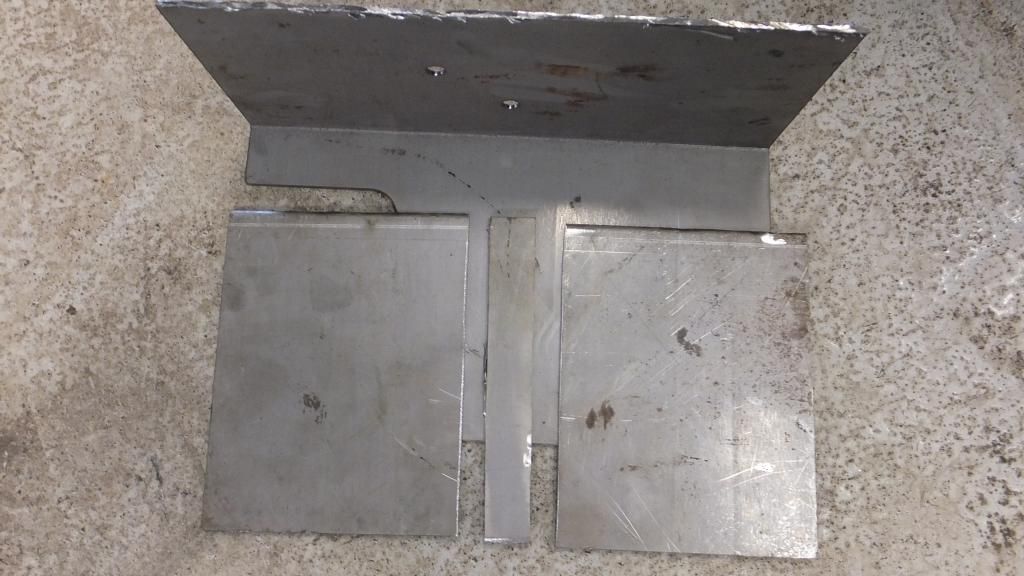

I'm not sure what these are for, found them in the dumpster. But they are roughly the right size, and are 1/8" thick.
Cut one to length and welded a patch into the notched area.

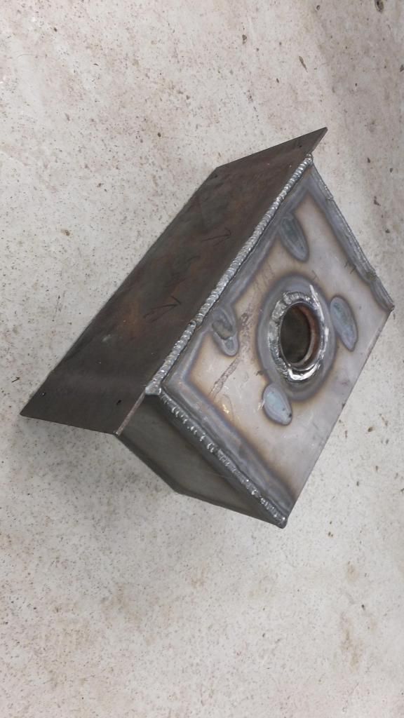

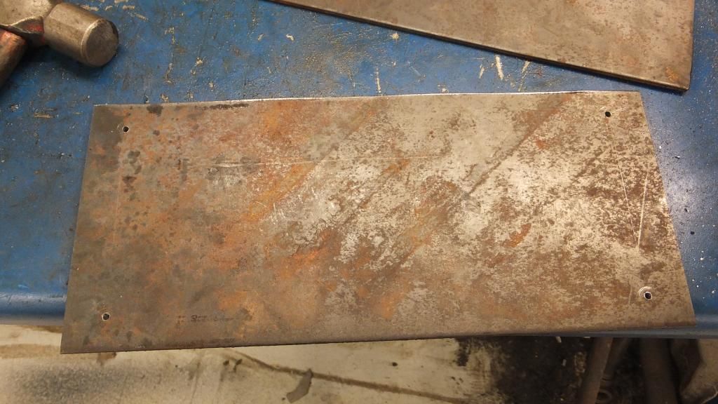

The back of the tank will serve as a mounting point, so I cut that out of some 3/16 steel and drilled pilot holes for my mounting bolts.
Cut out a pair of end caps

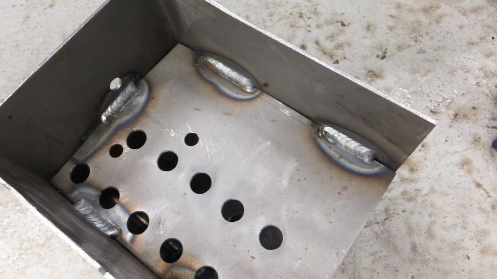

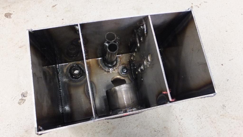

And cut out 2 more to serve a baffle plates inside the tank. This will slow down fluid sloshing around inside the tank and hopefully eliminate the chance of sucking air into the system.

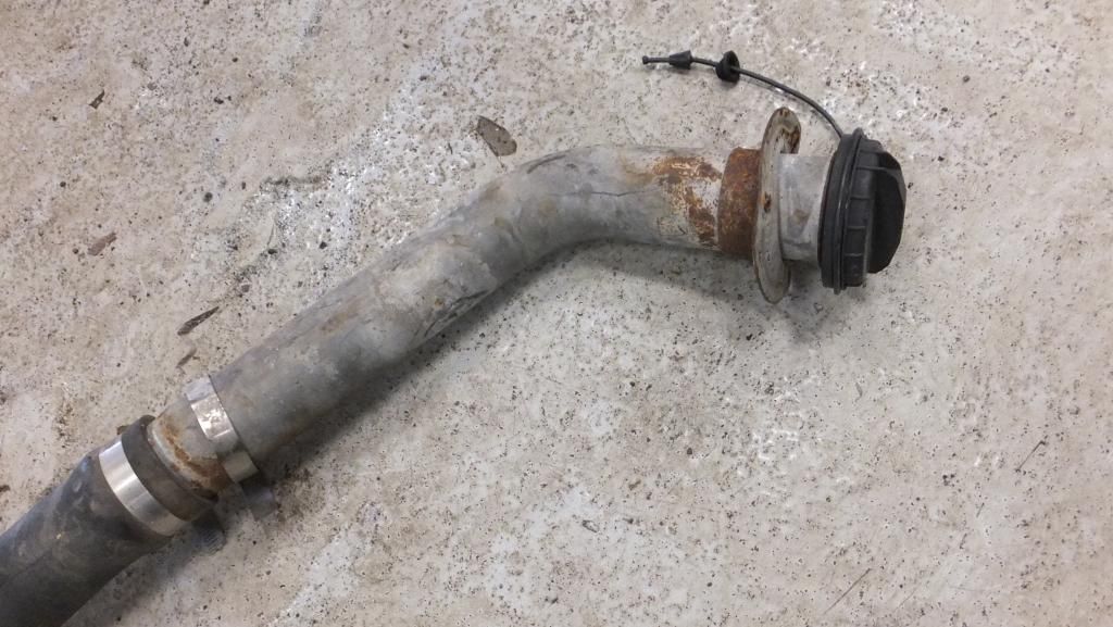

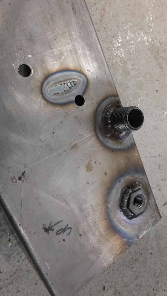

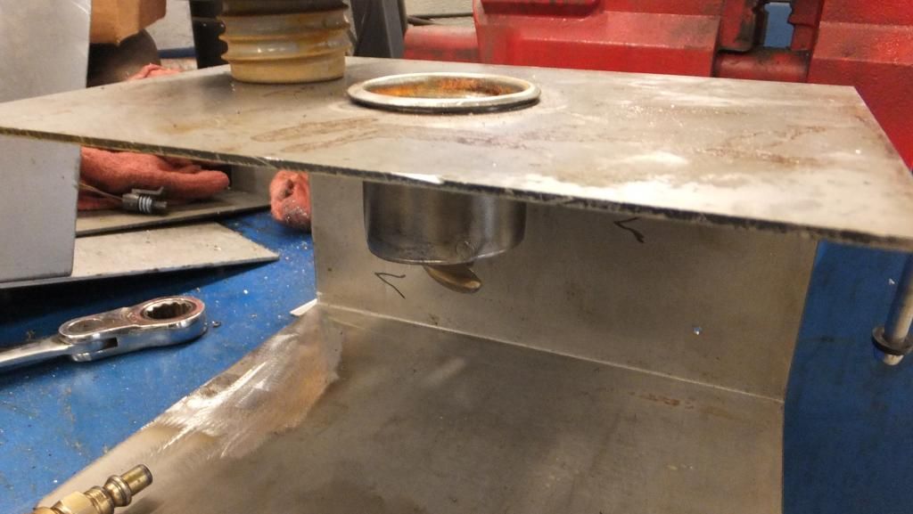

For a cap I used an old fuel filler neck.
Cut down and tacked in
Added some iron pipe for a feed port, cut so it will draw from the bottom center of the tank. Also welded in a bung (pipe bushing) for returning fluid.
Welded in the baffle plates. I did elongate a few holes in the lower row to aid in fluid flow.
Discussion starter · #186 ·
End caps on
And a view from inside. The reservoir is upside down in this pic.

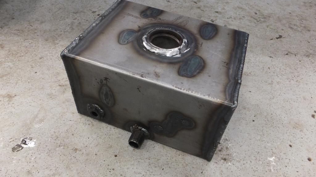

Rear plate welded on
All sealed up.
Plugged the ports and filled with oil. Will let it sit for a day or so and see if there are any leaks.
Discussion starter · #187 ·
There was some light seepage around the return port. Went around it again, then gave it a coat of paint. The same hammered bronze that is on the wheels.

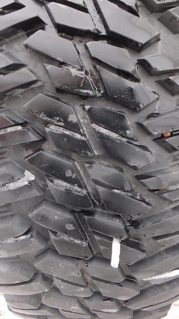

Did a little grooving on the MTRs today. May add some siping later on.
My MTRs are getting low and a few months ago, they got down to that block. It was quite easy to groove out, actually.
I might steal your cross groove idea when I put my 40s on, though - as they're also old-style MTRs.
Discussion starter · #193 ·
The grooves are between ÂĽ" and â…ś" deep and wound up about even with the top of that half block. Will have to find longer blades or use a saw.

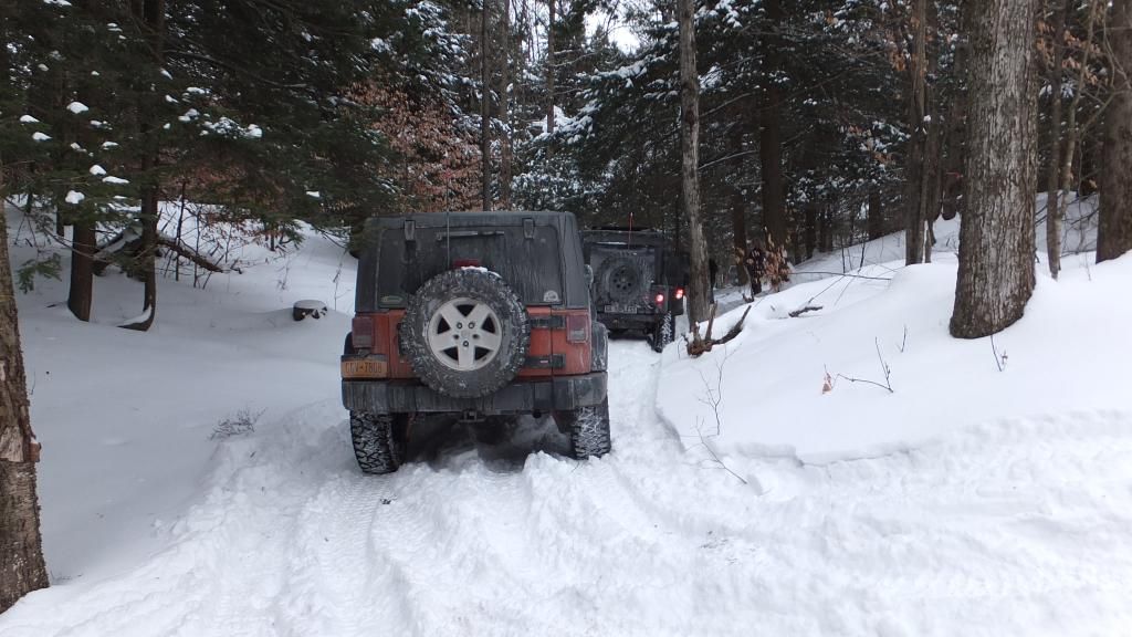

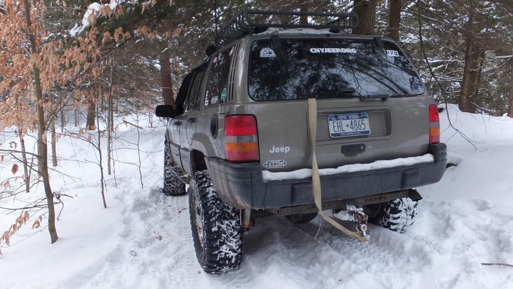

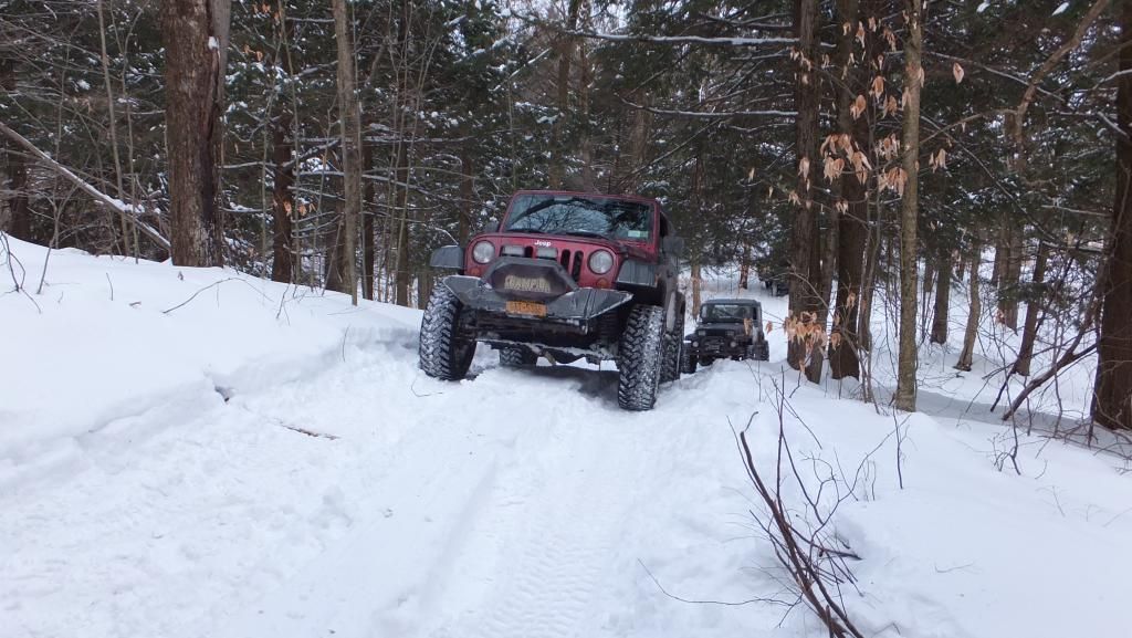

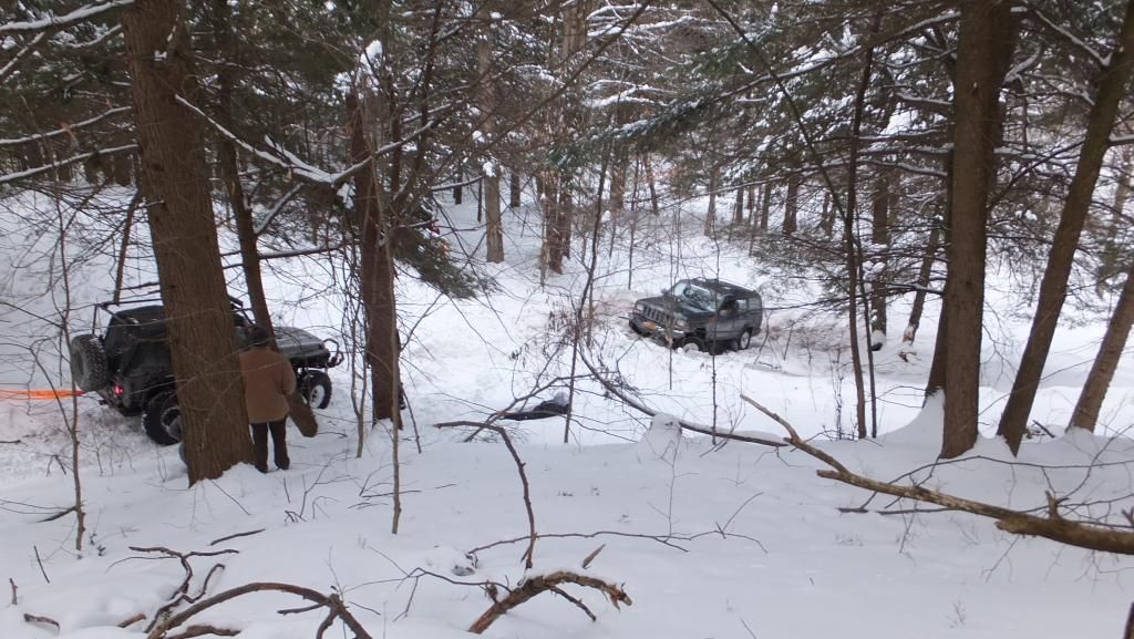

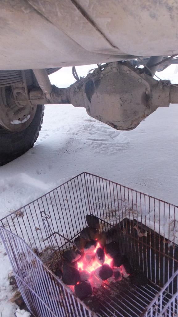

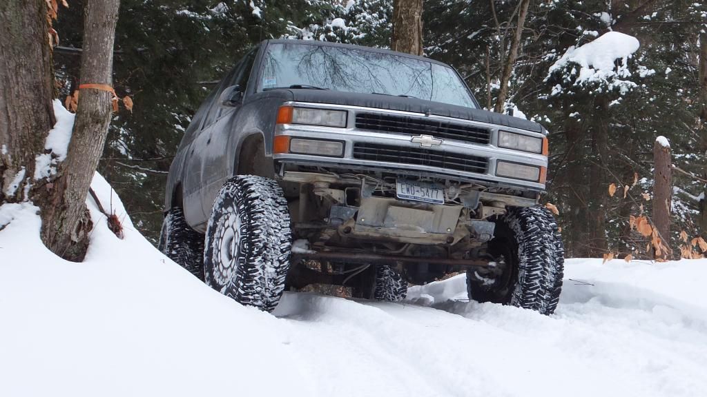

Out playing in the snow yesterday. A few lame pics, I didn't take many, but I did have a ton of fun.
And the joys of diesel fuel :shaking:
Discussion starter · #197 ·
Great to see snow wheeling pictures. Is the little red one a cut up Samari?
A what temperature does the diesel start to gel up?
These last few weeks been dumping lots of snow on you guys?
My family is originally from Buffalo and moved to Toledo, not much better!
We moved to Califonia in 1964, my folks moved back to the Toledo area, in 1971, I stayed here.
Last week I took pictures of the snow in the mountains behind my house, closest I've been in a while.
The last couple winters have been brutal back there, all my relatives are tired of winter.
Discussion starter · #199 · (Edited)
The red buggy is a cut up Tracker. He did the Ultimate adventure with it in 2008. Gone through some changes since then. 4x4 & Off Road Events at Four Wheeler Network
13° seems to be the cutoff for the burban, it was -11° that day. I dd a Jetta TDI and that will start at -20° with no problems. The snow has been a bit less than normal this year, average is roughly 190" of snow each season a bit east of Syracuse. Its the cloudy days that are wearing on me. Haven't had a sunny day this since before Christmas. Sometimes the sun will pop out for a few hours, but most days are dark and overcast. I'm ready for spring :laughing:

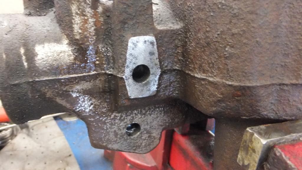

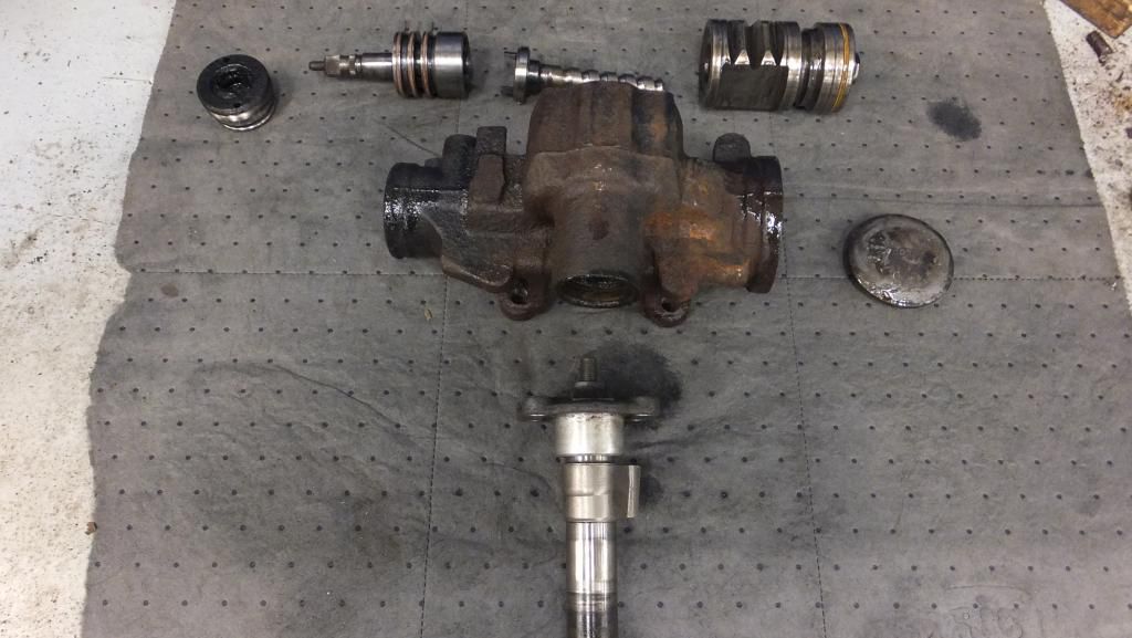

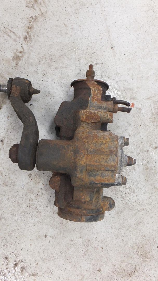

How's progress on the steering box going? I've not torn one down -yet, but saved one off my last donor/parts truck for this purpose-to either practice or put into my Burb. Been a long time waiting, key part SHOULD be shipping this week so hoping to finally start here real soon. This is one area I haven't messed with yet and looking forward to learning on shortly. Appreciate seeing you tearing into it along with the drill/tap at same time. Going OK so far? Any tips or pointers? Again, love the Burb, nice work.
