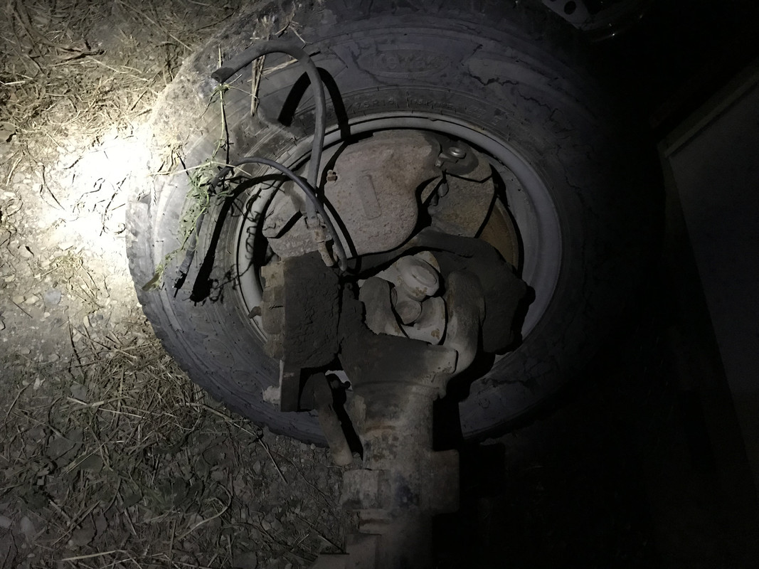

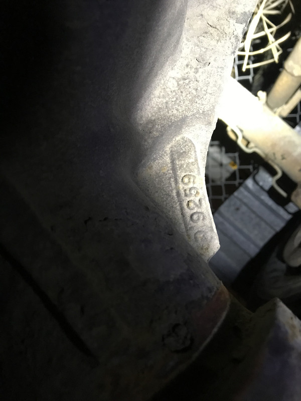

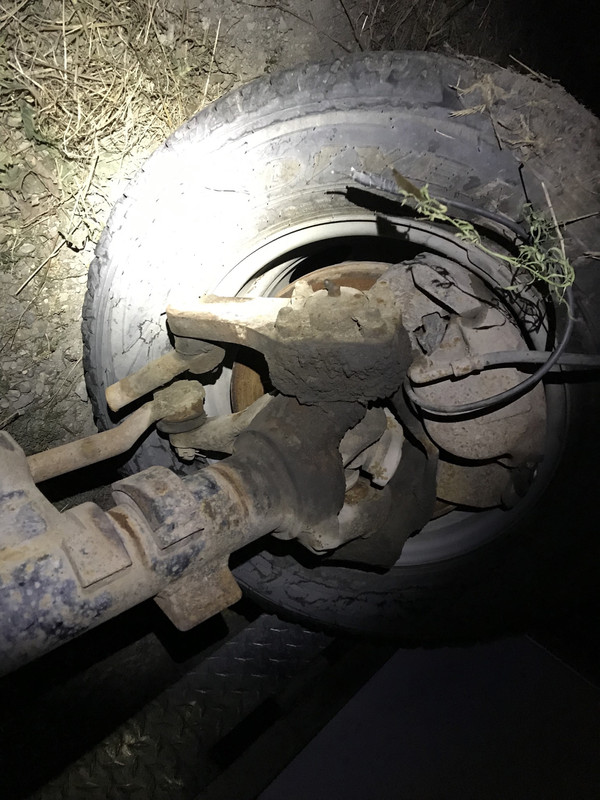

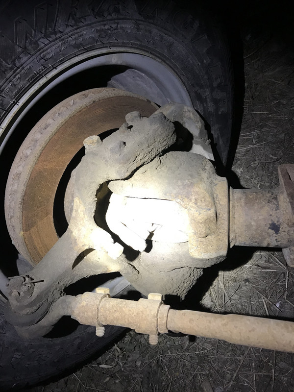

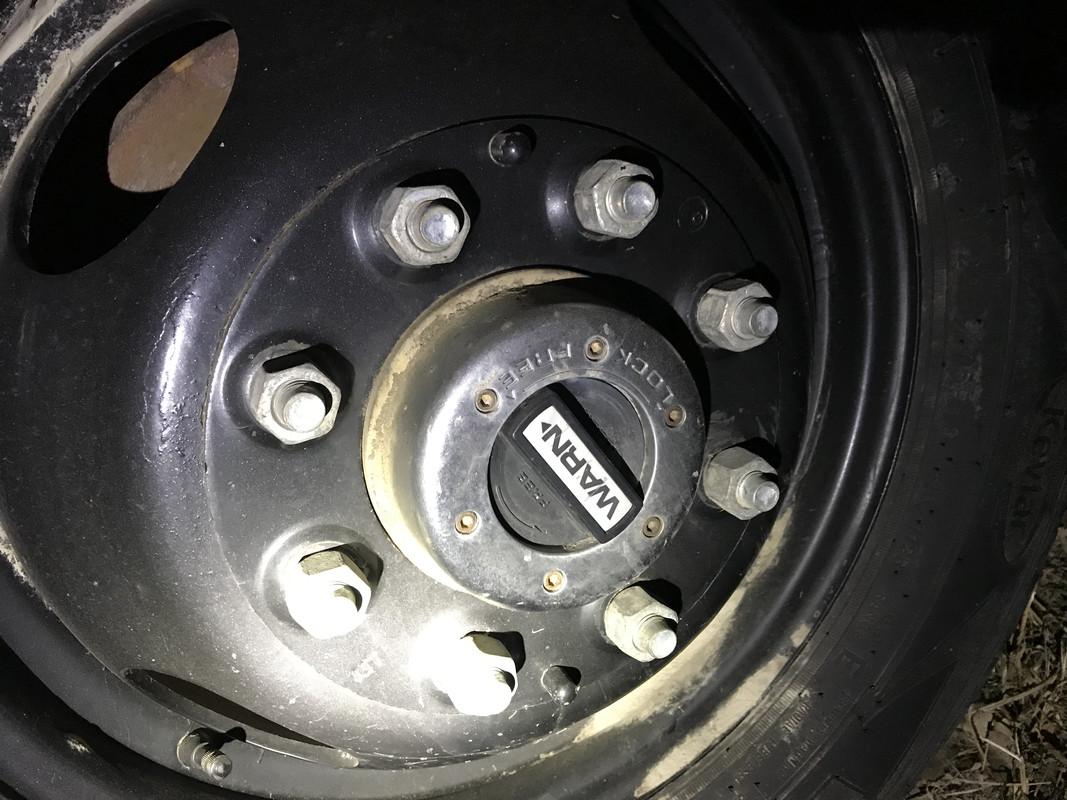

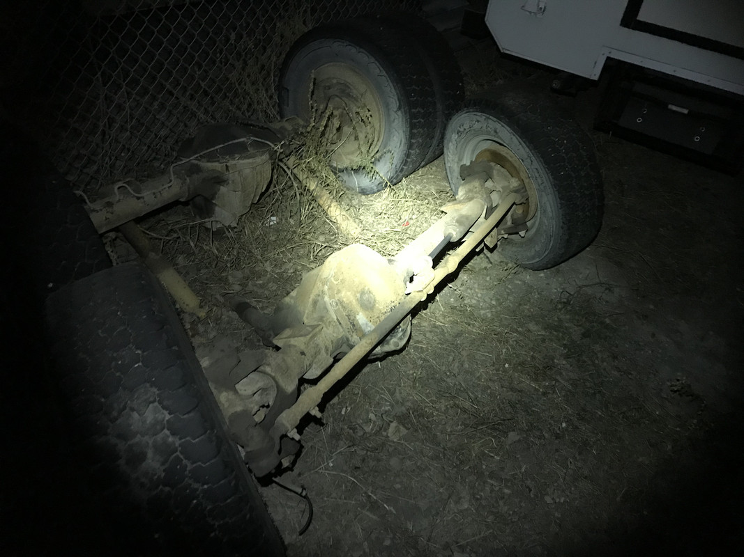

Discussion starter · #29 ·
Thanks for the info fellas.
Here’s another question if anyone knows. I found a good price on a 2012 f350 front d60.
It’s from a dually. But it is the same axles as an SRW?? I’ve come to the xonclusion that the brakes are bigger. Is everything else the same? C’s? Width(without the hub adapters)?
Not sure if I can use this axle or not. I could get an srw too but it’s buried in the back of their yard and impossible to get at.
Iirc, everything is the same except there are "wheel spacers" bolted on. You can remove them and replace the coarse thread studs with fine thread, to end up srw.
X2 if you can get a good deal on that scoop it, they are a bit wider after 05, ditch the dually adapters as mentioned and run wheel spacers on the rear if you wanna match up width, you can run the coarse thread 99-00 lug nuts if you don't want to change the studs .
Discussion starter · #33 ·
Ok so, after looking at the parts numbers on rock auto I have found that
Brake calipers are different, as well as pads
Unit bearing are different.
I’m a little worried. I told the guy to go ahead and cut out the drw axle for me. As the srw one is buried in the back do their yard and no eta on getting it cut out. Both are super cheap.
Wtf would the difference be in the unit bearing be?!
Probably the studs since the drw has course thread studs to hold the adapter on and srw is fine thread.
