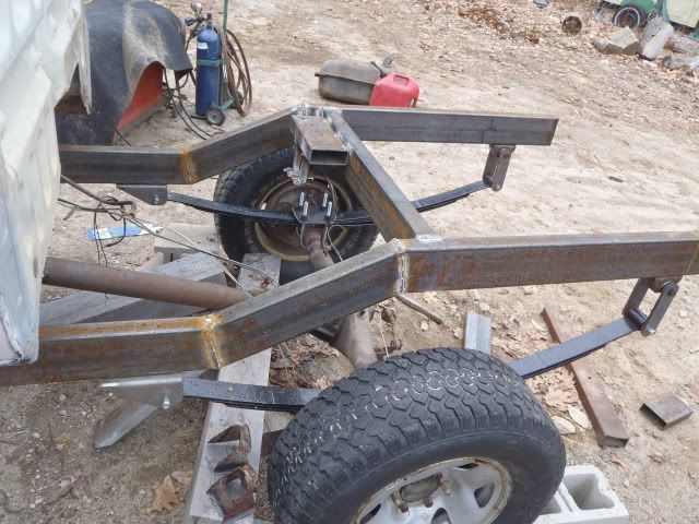

Can someone on here show some example pics of failed frames when not plating the sides at the joints? I want to show someone that this as it is is a bad idea:

Looking at the shitty welds, not cleaning the areas to be welded with a flap wheel all I see is fail written all over it. Yes it does need to be plated, what special school does your buddy go to?

PLATE those joints! 1/8" would be ok with some long fish plates and rosets. Stock rails are only 1/8" on outside, top ,and bottom. Did he go all the way to the factory joint on the inside of the rail? Do a 8-10" stagger and weld it up and then take your grinder to the top and bottom with 1/4" thick wheel , slice the rail so you can put a 3/16" plate through the inside. Then weld that to the rail top and bottom.

I never said it was a friend or a buddy, I've never met him. Just a guy on our local board and I was trying to offer him some constructive critism. That's why I was looking for some fail pics to show him it's a bad idea.
I already showed him how I did mine:
I didn't start this thread to bash him, but rather show him why I disagree, looking for pics...

frame is 2x5 3/16th thick, truck has been airborn multipal times, even recently flipped with not damage to any of the frame i build. i may add some plates now that everything is ripped down but i drove it for 8 months on the rd and trails problem free. but thanks for everyones consern :flipoff2:
everything was welded by some who knows what they are doing, the welds penetrated just fine and sorry i didnt care to clean them up. but its solid
not sure how my cross members are trailer inspired? if you are referring to the gas tank bracket it was only a temporary fix, tank if moved now.
all the metal was brand new and very well cleaned before welding, this picture was just after a couple of days sitting outside. the welds are more then strong.

the frame will probably hold up like it has been, but go ahead and add some fish plates just to make it that much stronger, it wont take much work or time.

I agree with rockyota just ignore the shit. We have equipment trailers that arenot fishplated and have been fine the past 10 years. If welded properly it will be plenty strong. It's up to you on the plates, but remember it will only make it stronger.
