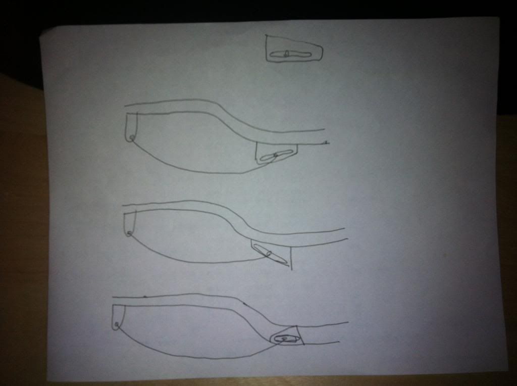

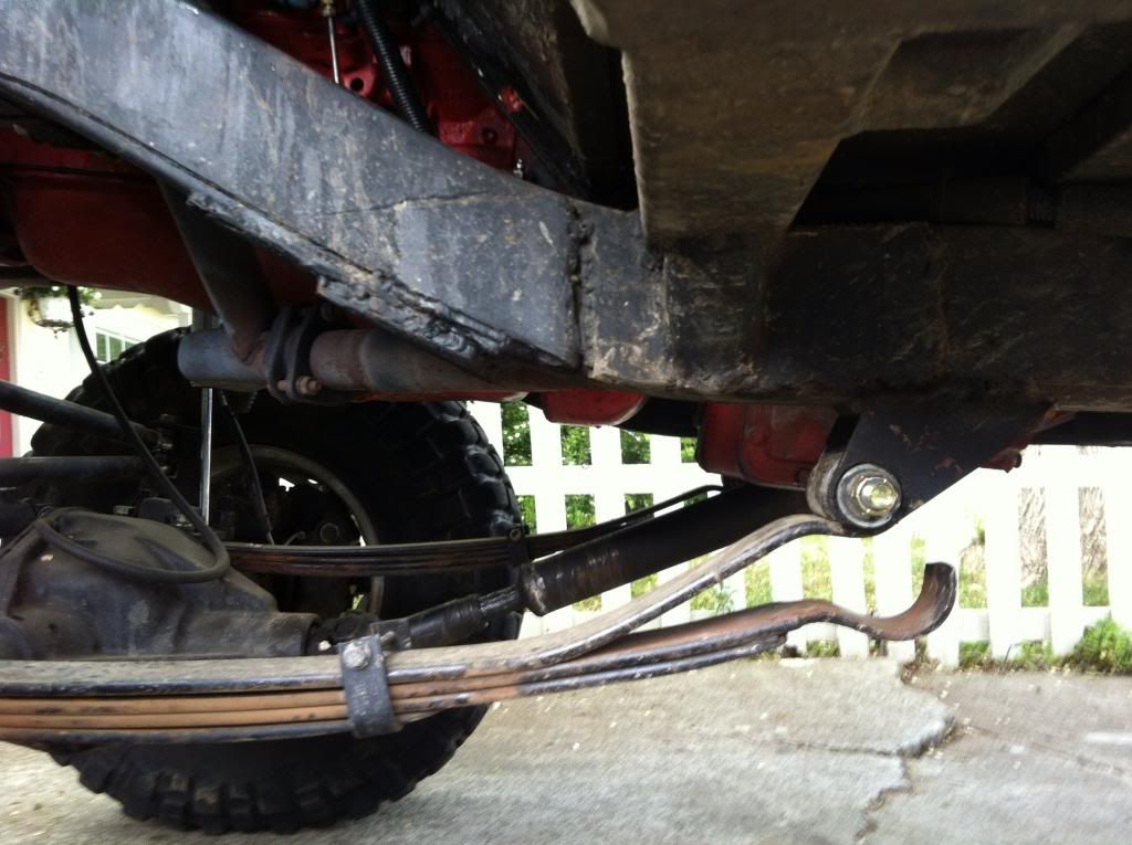

I'm trying to figure out the best way to install these (if I get them).
I'm doing my RS & if I put normal shackle & bushings through the frame, I run into issues with my slider mount & gusset being in the way (the shackle hanger would be about 2" to the left of the bolt in the pic):
Here is a crude drawing of my options with the slider.
Slider for reference:

You will want your first drawing or the same thing slightly frenched.
For reference, these are the new version of our boxes. They are formed 1/4" instead of the welded version pictured. The UHMW pucks and spacers are also all CNC machined for accuracy to ensure the smoothest operation.
Why mount them angled instead of flat? If you mount flat, you have the advantage of a non changing spring rate. When mounted at an angle, you have the same changing rate you see with a shackle?
The best research for these is done in the circle track world- they all run them and definitely not at an angle....
