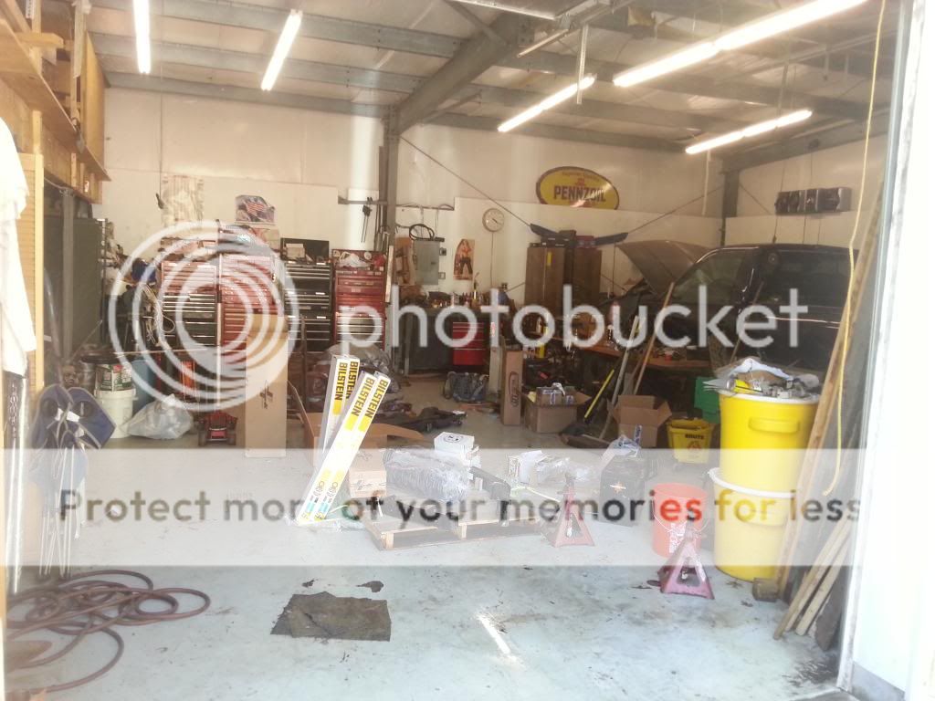

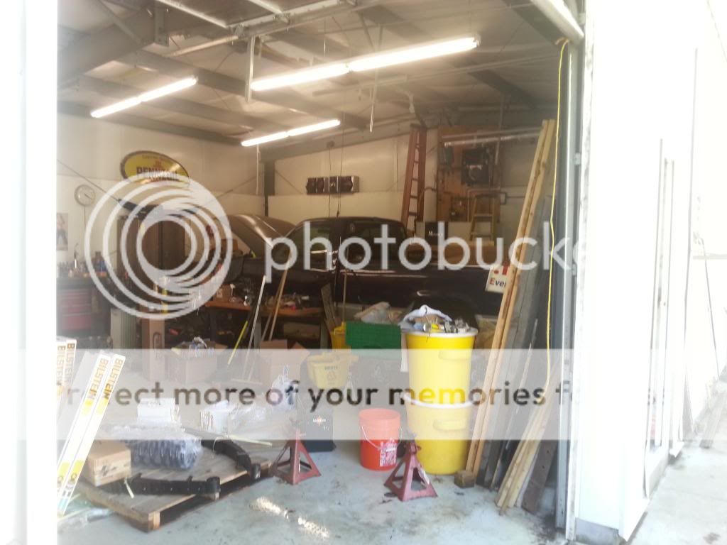

I don't want to be the guy to bring you down, but I don't see 5-6 cars fitting in there, unless you figure storage on the lift with one under it. Don't forget 36' x 40' is (generally) the outside dimension, when you factor in wall thickness and foundation you already start losing interior space.
My father built a 30'x40' garage about 7 yrs ago, 2 10'x10' doors and a walkthru. We originally figured 3-4 cars inside. We built a loft 30'x 8' for extra storage and a work area underneath, we built a small,6'x6', compressor/utility closet under it also. The exterior walls are where the tool boxes and benches are. So after that I have an "open" area of about 25'x30'..it's just barely enough to have a project in there and have one open bay, I COULD squeeze 3 in there, but it would be TIGHT!
I know, I know it's a friggan mess..maybe if i cleaned it I could "fit" 4 cars..but mostly just for storage at that point, they would be door handle to door handle.
As for the compressor, I have a 80gal husky from home depot that is rated for continuous duty, been working fine for my blasting, it will lose a little pressure with long jobs,but I do have a 200gal air tank i will be plumbing in for exta capacity.
Run your water lines below your frost line, DO IT! Why take a chance if it's just a little more work to dig down another foot or so. Run electric ABOVE, and preferable to the side of the water. we ran a 4" length of sch80 to snake some 2" black plastic (pvc?) water line and then a 2" sch 80 for phone, internet, etc. Garage has it's own separate electric and gas, we wanted to be able to track power/gas usage just incase we wanted to run a business out of it.
Open span loft. Under loft:compressor room, fab area(welder,plasma,band saw,cutoff saw, sandblast cab,bender,press drill press fab table) and parts/hardware storage - the back 6x6 corner is full of divider drawers,nut/bolt cabinets,misc hardware,spare parts
Tools and benches on back wall
Reg cab 8'bed chevy, has about 3' all around for working space, those benches in the middle of the shop are temp right now. you can also see my ( out of commission) radiant heat system..warm floors were nice in the winter. If you look next to the jackstand closest to the door you can see a round hole next to it, those are body shop tie downs we had put into the floor when it was poured, nice to have, only a couple hundred bucks for the 8 or 10 i put in.
