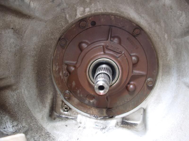

I hope this will help some of you guys out, I was searching all over the web for this info with pictures and never had any luck finding it. This is a write up of how to weld shut the famous "low vent hole" that kills the Jeep automatic transmission (caused from going too deep in the drink), and relocate it to the top of the tranny case. This tranny (TF999) is out of a 1989 YJ with the 6 banger. This will probably work on other trannies as well.
1. Here is a shot of the vent in it's original spot, just behind the torque converter (hole next to bolt, upper left)

Good idea, but here are a couple of things you may want and not want to do. Tap the pump back in with a plastic hammer, and dead blow, the handle of your hammer, whatever, dont pull the pump in with the bolts. I would have put new bushing and seal in the front pump half when it was apart, and put a new case gasket, and outer o-ring on the pump.

I posted something similar to this about four or five years ago. I have done a few dozen of these since then.
I just tap the pump with a 1/8 NPT plug. Just make sure you get a plug that does not stick out too far, or the converter will hit it. I also put my vent right behind where the second gear band is. I did this to keep fluid from slinging into the vent line off of the rotating internals.
A 727 is similar, but different. The second pump half does not go all the way to the vent, so there is a plastic deflector on the inside to keep fluid from seeping out. Remove this, tap and plug.
