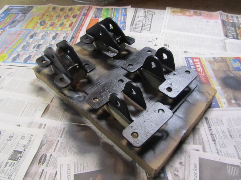

Do they need to be 12 feet long? I was thinking about the same thing, if i get on it in first and shift to 2nd it will start hopping pretty good. I was thinking about make some that attach below the axle and right in front of the leaf spring mount. Just fixed ends, no shackle, I never take the truck off road.
#18 ·
The longer the better, but more importantly it should mimic the angle of the rear driveshaft
I've also been told the length should be near or at the mounting flange for the rear driveshaft
#24 ·
I don't think length is as important as the mounting points are. If the axles moves while the suspension cycles, the link can't inhibit that movement and needs to be set-up in a way to allow that movement to happen. A longer link will make it easier, but would probably mostly depend on how much suspension movement there is.

A little late to the party but what about this?
Antiwrap/Traction Bar Complete Kit - RuffStuff Specialties
I ordered the kit with the longer tubing when they had the 25% off sale. Will probably put it together next weekend and if it looks like it will work (for an 05 dodge dually) I will order another kit to complete the pair.
Even with the 5', 2" .25 wall and 4', 1.75" .25 wall options it was still under $200 to my door during the sale.
