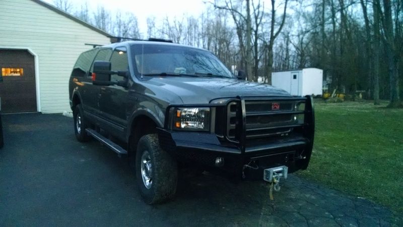

Anyway I put a 9k winch on a fab fours winch bumper on my excursion and I could get some decent use out of a set up like this on my front bumper. 2 weld on clevis mounts, two 20' sticks of tube with clevis welded on both ends, bolt onto the bumper on the bottom, a big bolt through both and a snatch block up top, tighten the winch and lift the whole assembly before tying it back to the tow hooks on the bumper with a short loop of cable or chain, then use the winch as my main line.
I'm sure someone has tried this.

There's a 92ish F-superduty in my hometown that's had one of those on plow mounts since probably 1992. I guess it works well for what they do with it. For rear mounted cranes (not really relevant to you since you don't have a bed on the excursion and plan on putting it on the front) if you make a U instead of an A and use hydraulic cylinders to move it (so it doesn't crash into the cab once it's past 90deg) you can pick stuff up and put it down on the bed.
For mounting a crane like that you've gotta be a lot more conscious of twisting forces. Winch bumpers are meant for straight line pull and generally don't have nearly as wide of a mounting footprint on the frame as rear bumpers can be made to have. That's why those bumpers with actual HD brush guards on them tend to bend the frame up when they get in a serous crash. A crane applies less force but has more leverage in the opposite direction. I don't think you'll bend the frame without crashing into something, but there's not much vertical or horizontal (in the fore-aft direction) spacing on the bumper mounts so that's something to be aware of.

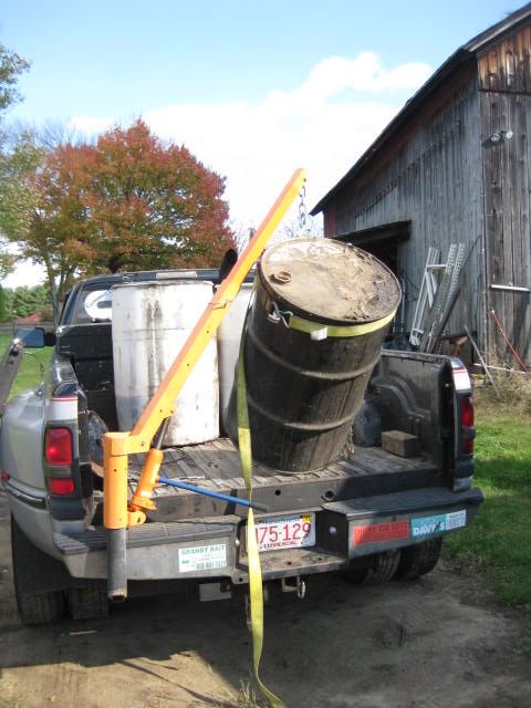

yeah , i think its called gin pole .... i just call it (add swiss-german accented) "zee Krane" :flipoff2:
absolutely LOVE it :smokin: .... could not imagine NOT having it
at the back of the <T> i added two extra hitch tubings, so it simply slips into them
the load and the angle of the hoist pull is holding it in (no pins needed)
so it mounts and de-mounts very quickly
i just loaded and unloaded a big trailer load of crap with it
(including this 26 foot deckover trailer frame) .... what a back saver!
however, i badly need a backup camera to do this alone
(getting in`n`out all the time to check position is getting tiresome :homer:)

#10 ·
yeah, the top line (or main hoist) is seeing some serious load
i think i actually stretched the chain on the 3 ton hoist :shaking: ...
to get the trailer frame out of its storing spot i had to pick it up on its long side so i had to lower the angle of the pole
...what raised the load on the hoist to the point of it making really funky noises :eek:
here is how i tied direct into the chassis for the top line (bypassing the rubber mounted bed);
do you have a engine hoist ? ...
mounting big tires and a tongue (as well as a front hitch on your rig) may work for you
here is my setup (ex HF engine hoist):
somewhat limited in lifting capacity , but still very handy ;)

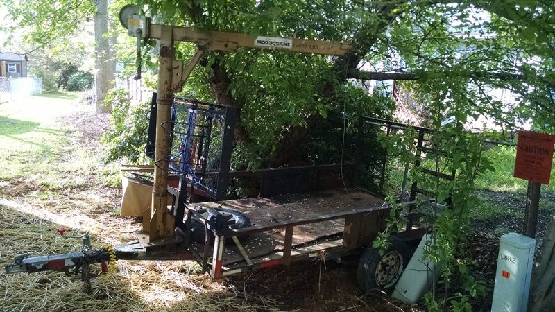

I could make a mount that bolted to the bottom of the bumper, used the winch to pull it up and then used my chain fall hoist on the end... Just not sure how that would work with the winch being only 6" above where the pipe mounted.

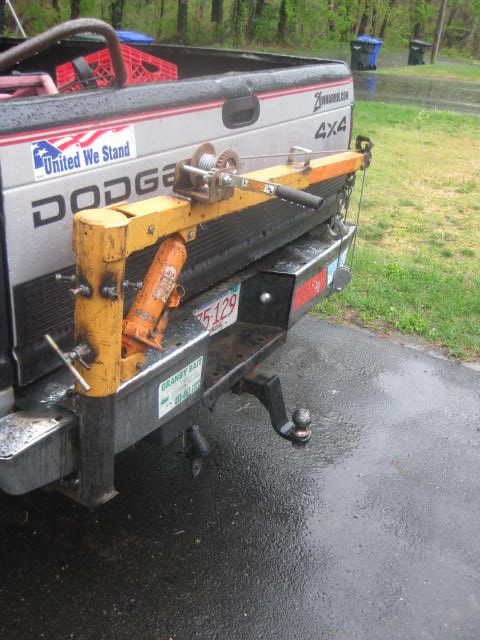

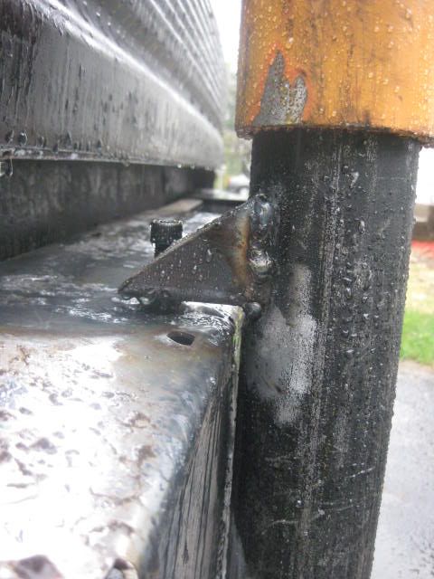

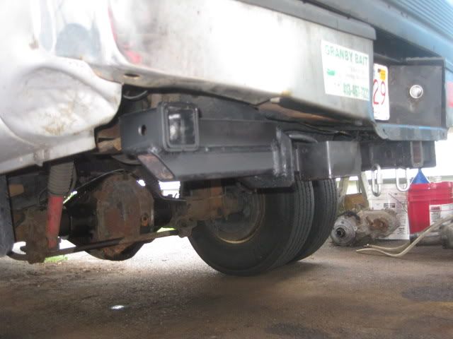

Either add a roller above the pipe to push the winch cable up, or lower the legs. If you brace it correctly, it'll significantly reduce the overall load, but I can't be more specific without seeing a pic or 3 of your truck.
On my dually, I wanted a crane that stored completely out-of-the-way and below the bedrail (in case I switched from a camper to a tonneau), so I concocted this cantilever crane:
I never found its limit, even using an extra-long thin-walled boom. It also worked for R&I-ing the camper.
On my Bronco, I designed the front bumper with 2 standard 2" receivers so I could attach recovery points (shown), or a tow bar, or a snow plow, or anything else.
That would make attaching an A-frame very simple & sturdy. Attaching it farther out at the tips of the bumper would DEcrease the overal capacity of the system.

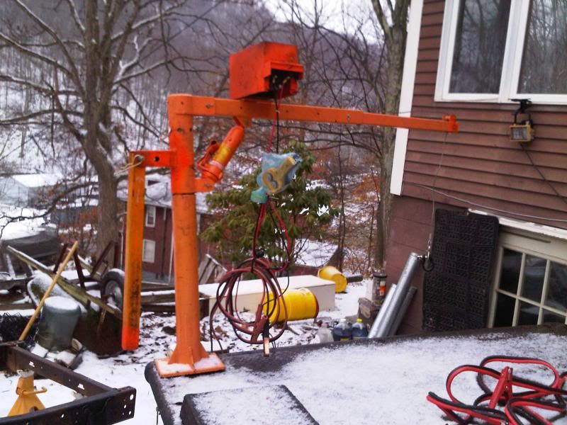

#24 ·
