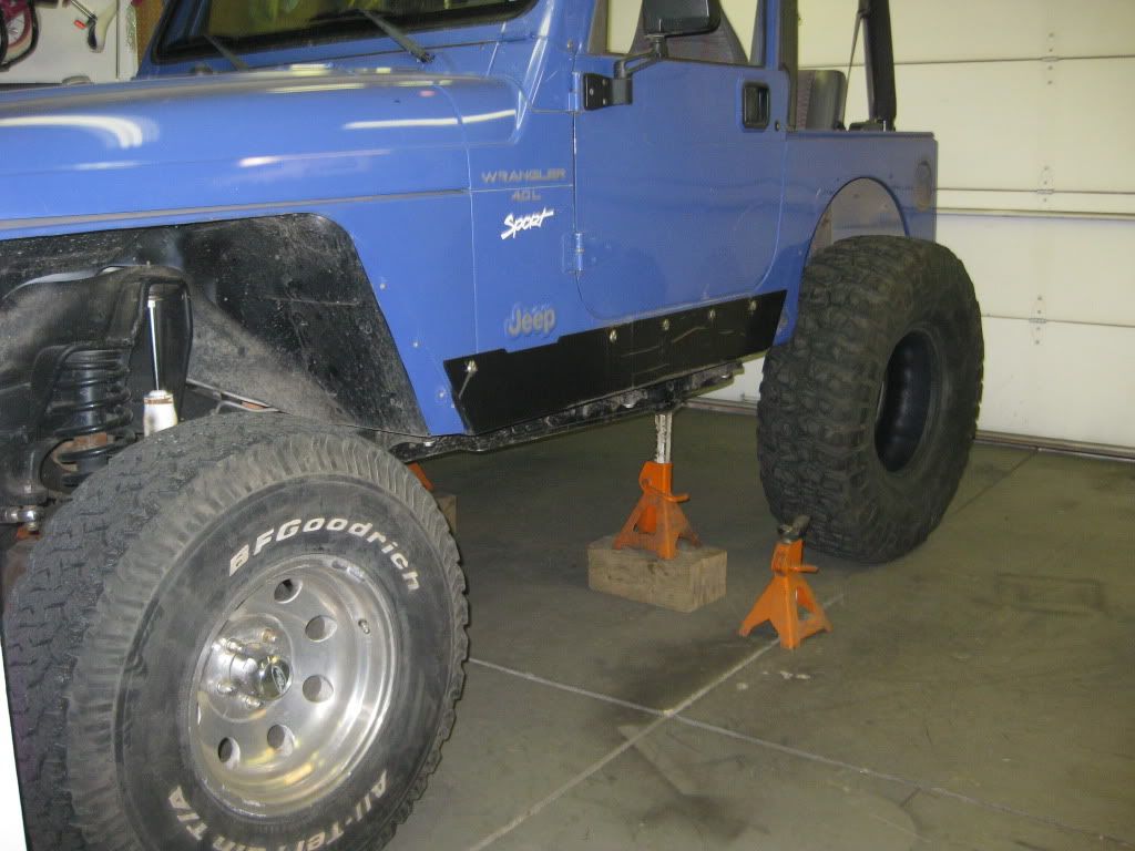

We picked this up a couple years ago 98 TJ 4 "lift 33 10.50 tires.
It didn't take me long to figure out I wanted lockers, my last 4x had welded diffs front and rear and well every one says to build it the way you want it the first time and the lockers and gears cost about the dame for a d44 compared to d60 so what the heck.

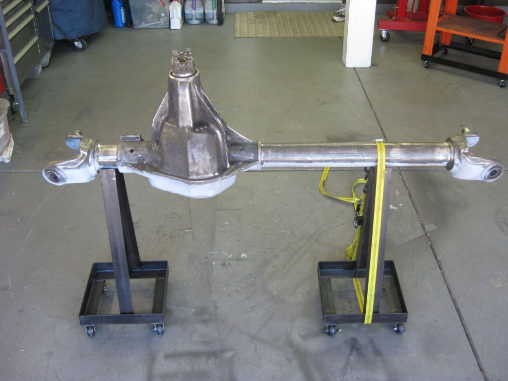

I ended up finding a D60 rear with 5.13 gears, ARB and disc breaks for $800. With the WMS that i wanted 66" so it came home with me.

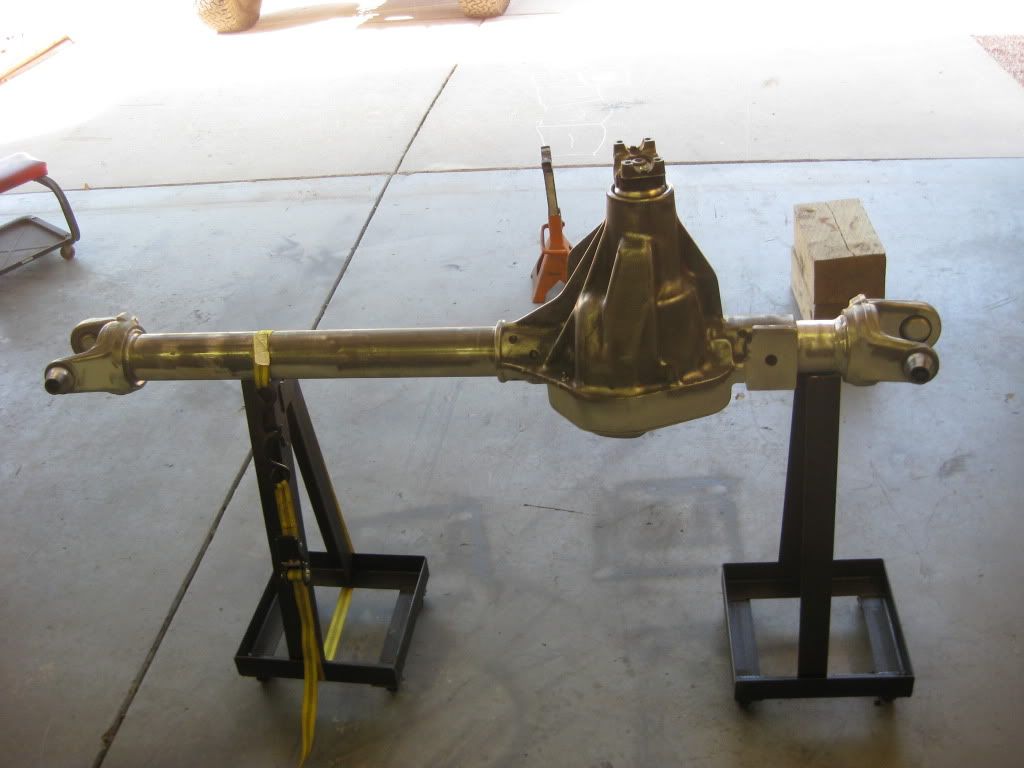

Then a 88 ford front 60 was found from a dually with single rear wheel hubs, from what i figured out if i cut 2 1/8" off the passenger side that will put it at 67" WMS perfect!
While my dad was here visiting we built the frond end what a great project for father and son, before he arrived I was able to get it cut down and the knuckle welded on.
Went with 4340 axles throughout and 35 sp outers, ARB, 5.13 rears, king pin rebuild kits, new discs and calipers, was gonna run the factory knuckles now I'm gonna beef them up first.

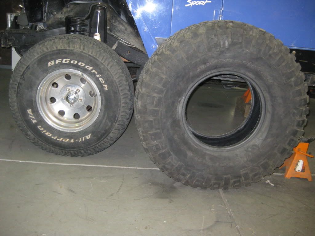

I ended up buying a set of 40" BFG km2's slightly used from a local guy.
