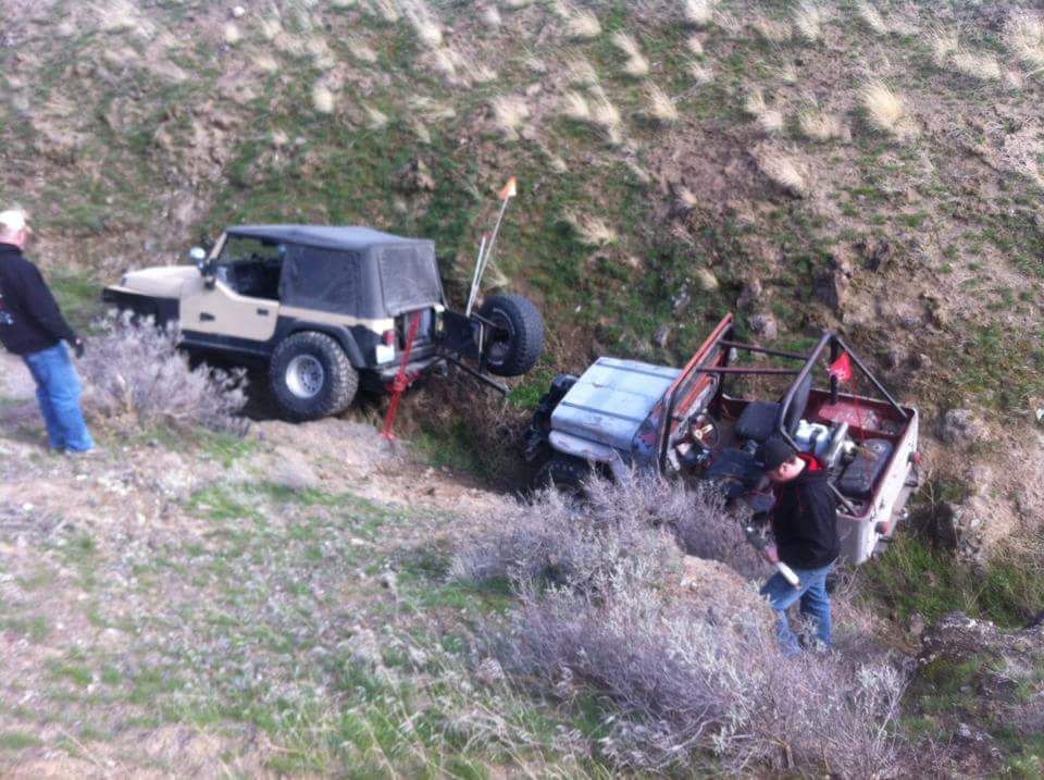

actually took it out on a local trail run and it did great, needed some suspension modifications on the trail This is when I decided that a build was in store.
