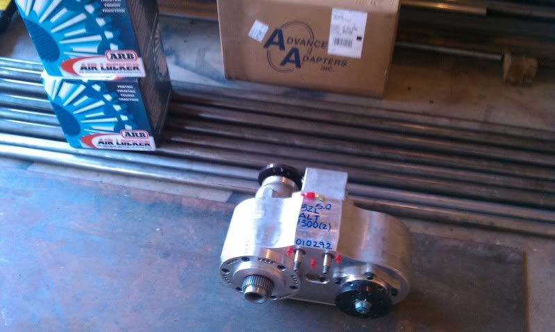

Well, I have been in the WEROCK circle for a little while. It was fun and expensive like everything else. Tired of traveling long distances to just wheel for a few minutes. Thought about building up a trail worthy rig with highway roads accessible in mind. Sure I will still use the enclosed trailer to haul for long weekend getaways or small events.
What I got and some ideas..
-97 TJ 4cyl TUB Salvage Title, hmm Registering
-2002 5.3, Novak headers, wiring
-2002 4L80E, Advanced adapter with VSS
-Atlas 5.0 with 1300 flanges
-2002 Ford Superduty F350/F450 HP60 axles shortened
-Unit Bearings (TG)
-Rear Unit Bearing Pockets, Spidertrax
-ARB's, 488's
-17" wheels
-37x12.50x17 MTR Kevlars
-Tundra Brakes.. Secret
-Genright Rear Full Stretch Corners
-Genright Rockers
-Genright 05-06 Fuel tank, higher PSI for LS engine
-1998 Durango Steering Box
-4qty 16" FOA 2.0 remote res Coilovers
-7/8" heims, 1.5" DOM .250 lower links, 1.5 .120 upper links
-1 3/4" DOM Roll cage material
-Race Trim Seats
-2x3 and 2x4 steel tube frame .120 wall

Another distraction, fabbing up a Rear ATV hauling rack, second reciever hitch to be welded onto hitch of truck for added stability.
Transfercase tucked up real high with future full flat belly pan across frame rails. Running into front driveshaft problems, potentially hitting 4L80E and floor pan. Moved drivetrain a few inches to the Passenger side. Might have to lengthen the axle tube on pass side, perhaps I shortened to much. Trying to make it slammed and some what leagal wheel base is really hard.

#27 · (Edited)
I think I got $600 for the engine with 50K miles
$400 for two adapters, VSS and main 4L80E-Atlas
$300 for used tranny 65k miles
$200 for headers, which not really needed
About $1500 into it so far. Now the ancillaries, radiator, computer, tune, shifter, plumbing will add up quickly. Not to bad if I watch the deals out there. The wire harnesses are getting readily available and easier to understand. Stock OEM computers can be programmed, pretty nifty.
